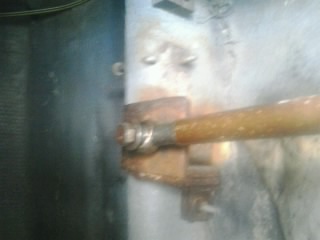

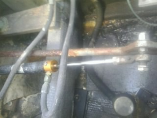

Re: Photo of Hydraulic Ram - F Series

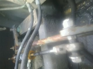

MIne , Done with a phone :| Similar to Harts but different joints and some extra rust

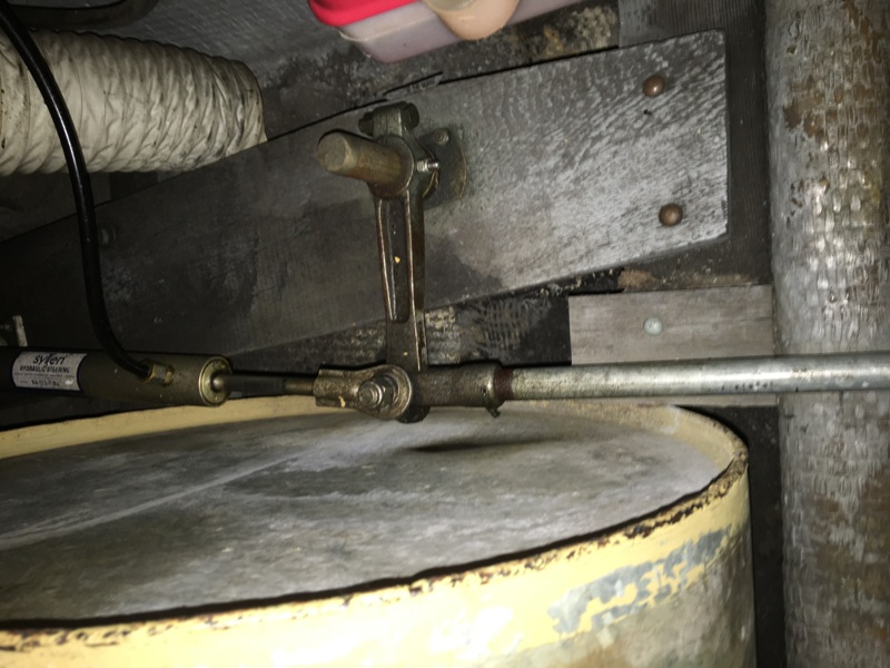

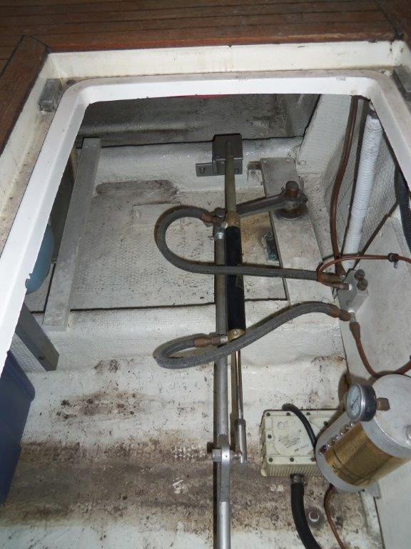

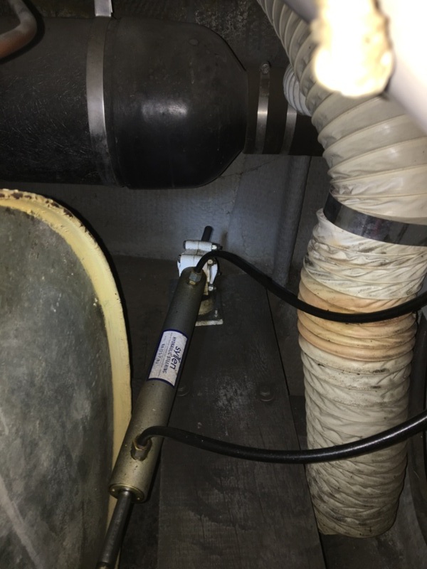

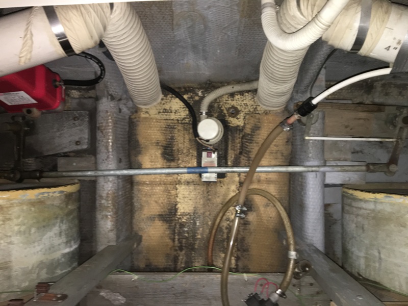

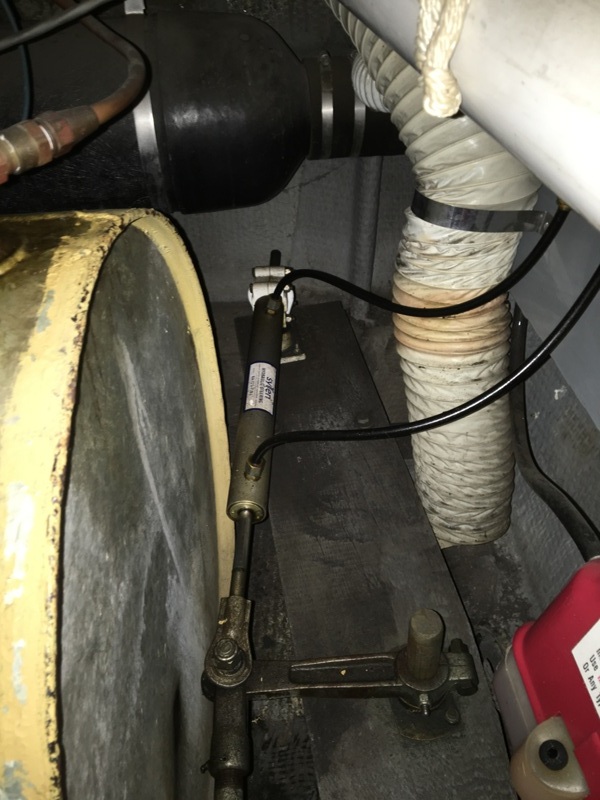

Got buggered up today and didn't make it down to the boat, so no good pics of installation of the NEW ram, but here are some shots of the old (Trojan original 1979 F32) setup... Hopefully have shots of the new one tomorrow night.
FYI - original Syten system had hoses from power steering hubs (pumps) to a 'uniflow valve', then two lines from the uniflow valve to the ram. Original setup on F36 and Tri Cabins differed... Current Telelflex SeaStar systems (as sold/marketed) have lines going direct to the RAM, but in my current config the uniflow valve is still there as it was reused by 'my guy' so I didn't have to replace all hydraulic lines with new lines of different diameter.

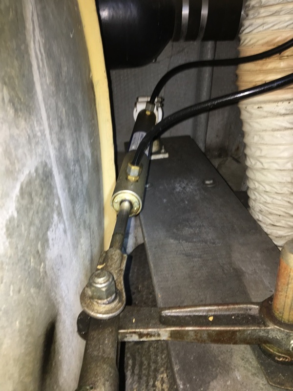

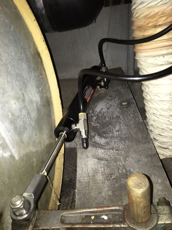

Finally have a shot of the new ram...
