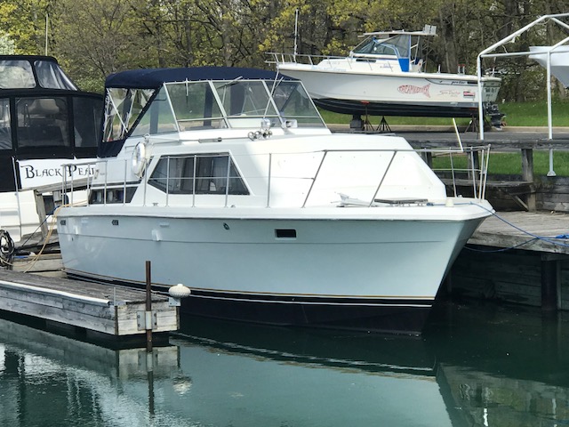

After soda blasting and base coating the bottom of our 1979 36 Tri, we put on Interlux ACT ablative dark blue bottom paint. It went on near black and after contact with the water it changed to medium blue above the water line (close to Trojan Blue). As the season went on it got lighter and chalkier. The next year we tried black with it turning to light grey. Is there an ablative paint that holds the color better or is that the nature of the beast.
36 Tri-cabin 20.jpg (125.78 KiB) Viewed 24431 times
