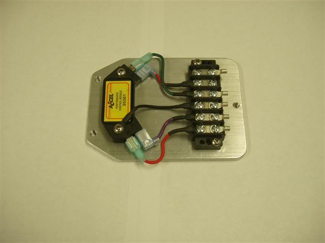

Thanks for the replies, I'm keeping the prestolite idh-7002 distributer, I have a reverse rotation 318, a replacement distributer apparently doesn't exist anymore, hurrikain has one, but appears to be a rebadged pertronix for ALOT. last season had some ignition gremlins. I feel an msd box with full 12v will simplify things a bit, considered this,

Interesting , That is a GM type ignition module on a plate .

Typical GM 4 terminal HEI, the aluminum plate acts as the heat sink, the GM module requires a full 12v to fire, so would need a relay in the start circuit. AC Delco modules are about 40$. The Chrysler pick up will trigger the module. Any reason not too?

Re: Msd ignition
44Ydnar88 wrote:Typical GM 4 terminal HEI, the aluminum plate acts as the heat sink, the GM module requires a full 12v to fire, so would need a relay in the start circuit. AC Delco modules are about 40$. The Chrysler pick up will trigger the module. Any reason not too?
Had a friend do a gm HEI marine conversion (newer type) and it never ran good ( for long ) . That style normally was used in a dist. with both mech and vacuum advance not sure you would get full advance . Is this even ok for marine use ? I always felt the stock Mopar electronic system was one of the best . I would stay with it . Be careful and make sure to use marine rated/approved ignition parts .

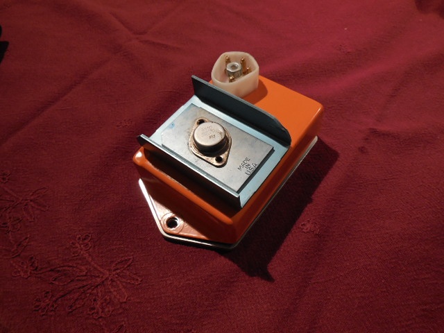

Are the replacement Chrysler ECU ignition protected? Sierra # 18-5105

Re: Msd ignition
With Sierra being a major and reputable marine parts suppler . I would feel safe that their products meet necessary specs . Some interesting fixes in your photos . But being a boat I would do it right or not at all but that's me .

Re: Msd ignition
44Ydnar88 wrote:[attachment=1]...Are the replacement Chrysler ECU ignition protected? Sierra # 18-5105
Yes
You never mentioned the symptoms you're having. Rather than throw a bunch of parts at a system that has a pretty good rap for dependable operation, maybe some diagnostics are in order to narrow down the source of the symptoms.
