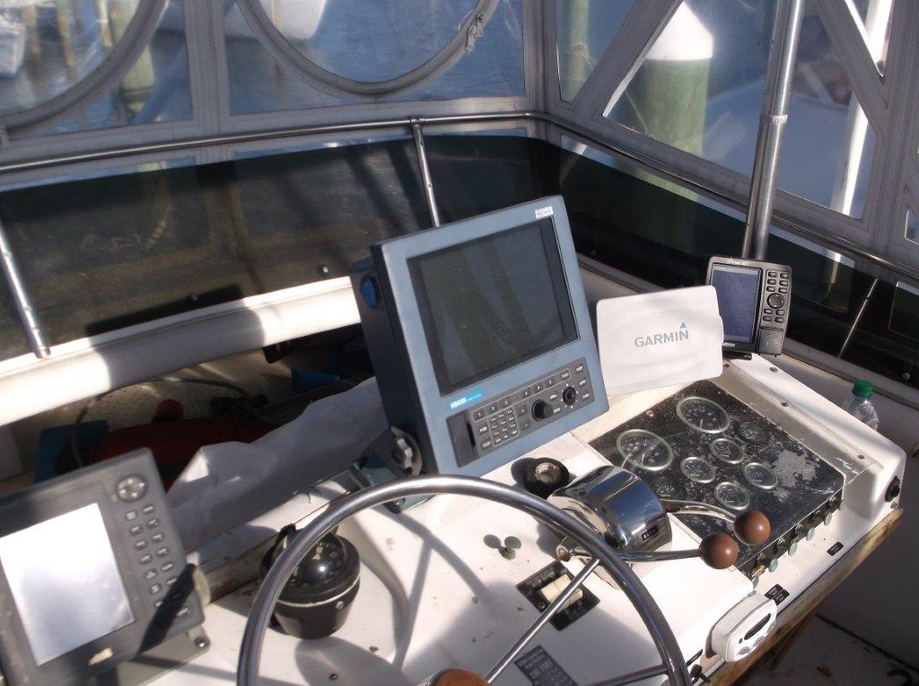

Photo of my helm 77/78 F36
And yes I repainted around the Gagues :mrgreen:

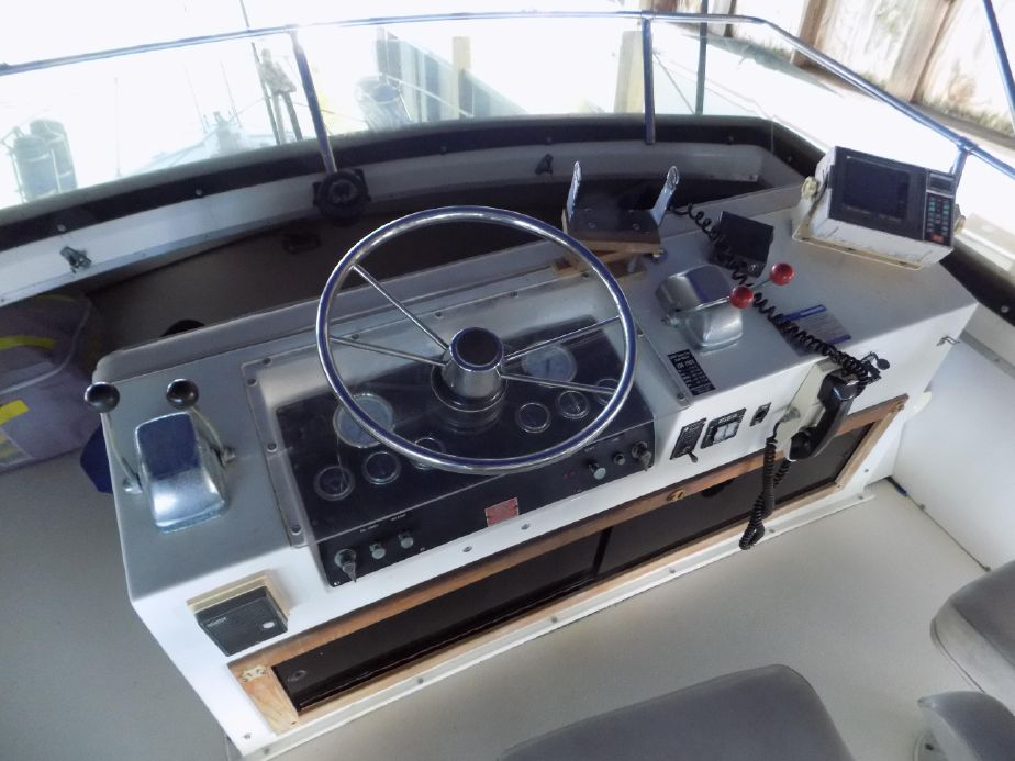

Ross this is a 78 F32 helm I found on Yacht world you could redo yours to be like this . I know someone that did it on a clean machine f30
1978 F32
1978 F32
F32 helm 78.jpg (85.48 KiB) Viewed 18684 times

Yes, that 78 is my helm with the built-in aft facing seat removed.
I really want something where I can mount electronics, etc. like the 80's upper helm consoles.
I'll have to add a U-Joint to the steering shaft...

Finally able to post a photo..
Here is Dan Faith's F32 upper helm:
Re: F32/F36 Upper Station Console
That's like the newer F36 ones
