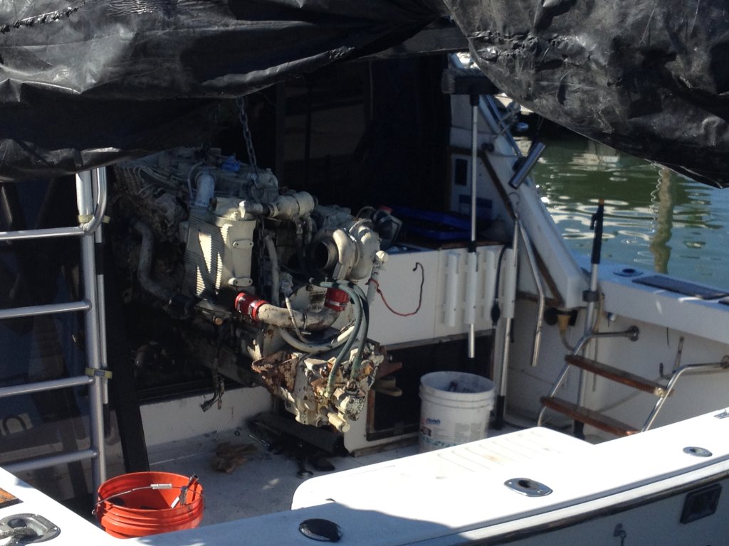

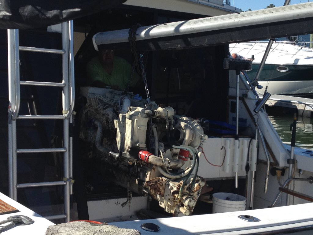

Well I got my 1400 lb engine out of my truck with a 2 two ton Harbor freight engine hoist ( better reach then the one ton )
http://www.harborfreight.com/2-ton-capa ... 60388.html
We use a fork lift to get the engine out .
This the same fork lift the use to dry store boats

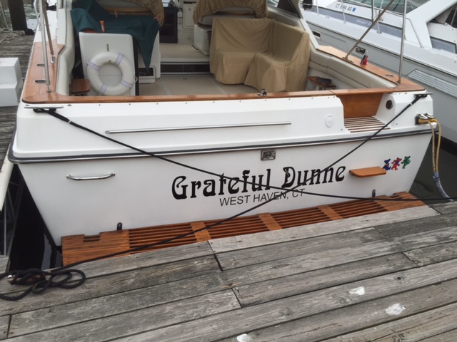

Off topic, Here's is a pic of my transom which I know you asked for a while ago. Notable upgrades are:
1) towel/grab rail
2) actual grab rail above ladder
3) eliminate factory ladder and installed under swim platform
4) relocated transom step (so it's centered in the opening) and made it bigger with teak overlay
5) relocated shore power outlets from Stb Side midship
6) made teak transom insert, mine was missing
7) teak swim platform from an old Chris Craft + underwater lights
8) fresh water washdown (not sure why my "8" is being converted to a smiley face but I'm going with it)
9) not really transom but in the pic, replaced rod holders with SS cupholders
1988 10m mid cabin

Thanks Bob! I really hope I don't have to deal with a rotten arch. My winter project list is way to big for that! Thanks for the transom pics! I've been waiting for that! I love the long grab rail. I may tackle my water logged platform this winter as well. I'd really like something that extends a bit further...

Well, they are out and nestled cozy in my garage, just waiting for me to pay them a little attention.
Special note to anyone hauling with a crane...pull them in front of the radar arch. We tried behind first and that was a fail. In front was perfect and easy.
