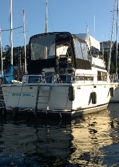

Hey Barrie, thanks. Yeah there are so many bad paint jobs that I might sand er right down. By the way, I recall this post, how are the patches you made holding up? Did u use reinforced fiber stuff? I need to do that too. Here is mine from the rear.
