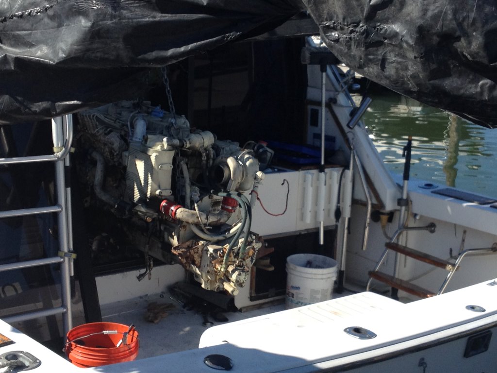

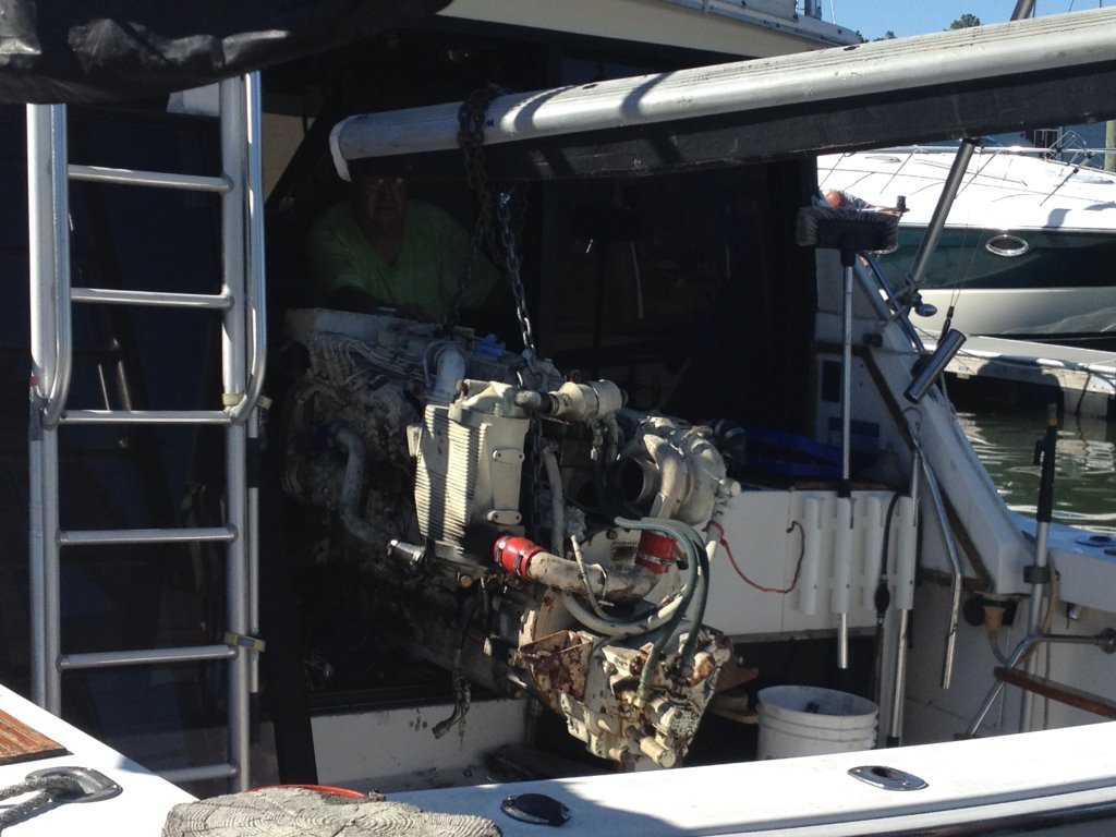

This subject came up a while back on a f32 . My answer was to use a fork lift . At the time I did not expect to post photos . Well a few weekends ago my port engine went boom . So I had a busy day yesterday . I hope to be up and running to day
engine removal 2.jpg (125.56 KiB) Viewed 7344 times
engine removal.jpg (126.33 KiB) Viewed 7344 times

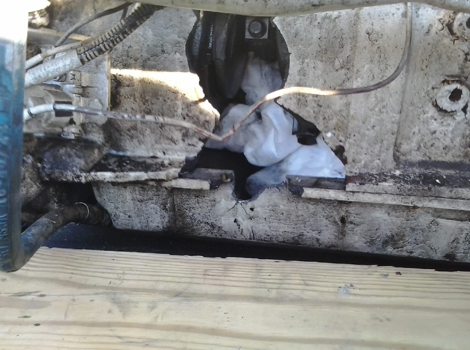

No rebuilding this one
engine hole.jpg (251.3 KiB) Viewed 7334 times

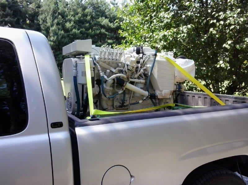

The fix
engine replacement 2.jpg (89.17 KiB) Viewed 7327 times

prowlersfish wrote:The fix
WOW!!!! You keep a lot more 'spares' than most!! :lol: :lol:

While that maybe true , I had to drive 4+ hours one way to get this ( with a lot of $$$). You can bet I will keep a lot of spares off the old engine :mrgreen:

prowlersfish wrote:...#5 rod left the building....No rebuilding this one
Ouch!

Sorry about that . :mrgreen: I will set the record straight first this happen on Saturday the 28 of may on the Memorial day weekend . Finding the problem was easy once the smoke cleared . Then I had to go engine shopping ( lot of junk out out there ) look at new too .I found this low hour used one 4+ hours away . Made a offer based on photos and video pending hearing run and inspection . found the money . Pick up the engine and left it at a friends ,rented a car then drove to Ct for Wes's funeral . 1300 miles later engine made it home (last Wednesday ) . This weekend made the swap . Its up and running but gauges not working I need to swap senders . Took the boat back to my marina on 1 engine but used the new one for only docking . No sea trial until the gauges100% .
