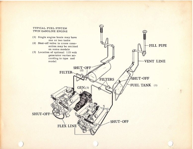

Re: 1970 Sea Raider Fuel System
This is from a 1969 Sea Skiff manual (the boat was a 28 footer, but the manual is somewhat generic). Only being one year off, it may reflect your config too.
So... one shutoff where the fuel line comes out of each tank, OPTIONAL shutoff in the crossover line, and one shutoff at the transition to flex line for each engine. Shutoff for crossover appears to control whether both engines feed off of both tanks, or each has its own dedicated tank. Generator (if you have one) may be tapped in to one of the tanks with dedicated shutoff at the tank and dedicated feed line.
