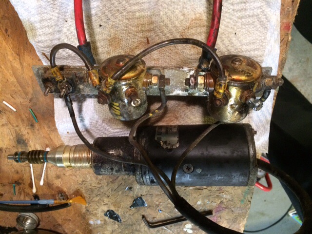

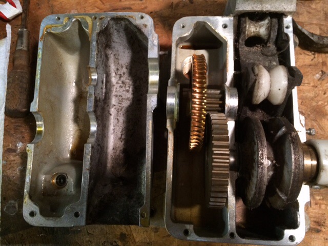

So the 5/8" Good Windlass was not working, took it off while the boat is on the hard. Put it on the bench and connected it to a car battery. Jumped the connections to similate the switch and the motor took right off. Both direction solenoids worked just fine, but were very corroded, so given the low cost, I will replace them. Either it was corrosion, or need to check the switch. Figured since I was this far, may as well crack the shell, and have a look inside. Oil was a bit on the goey side and somewhat low, however, the gears, and bearings were in like new condition. I will refill with oil and seal it up. But then thought.... Since I am this far,,,,, why not get the thing chromed up rather than keep the old dull faded rough finish. Has anyone done this? Or do you think the cost to chrome this one will cost as much as buying a new chromed one?

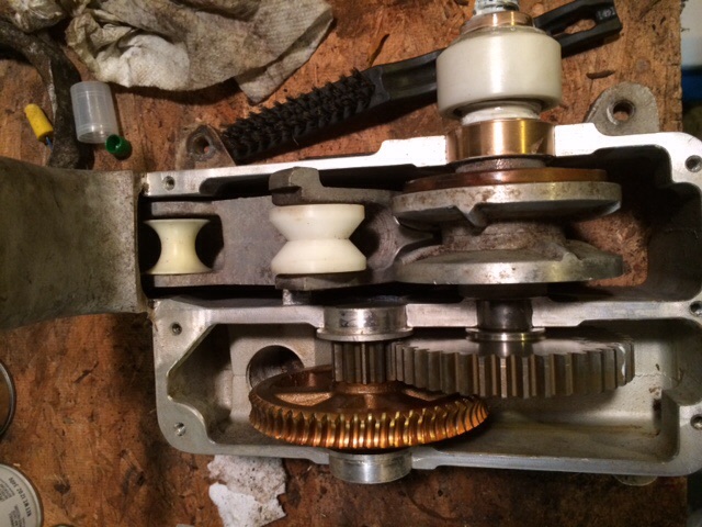

Here is the cleaned up unit. Used marine lithium grease for the bearings, and 140 awg gear oil for the reservoir. Re-sealed the cover and ready to paint.

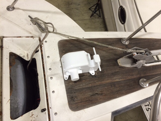

Here she is all painted up and mounted Not chrome, but looks better than scrubby grey....
1988 Trojan 11 Meter Express
Re: Good Windlass tuneup
Looks Great !
