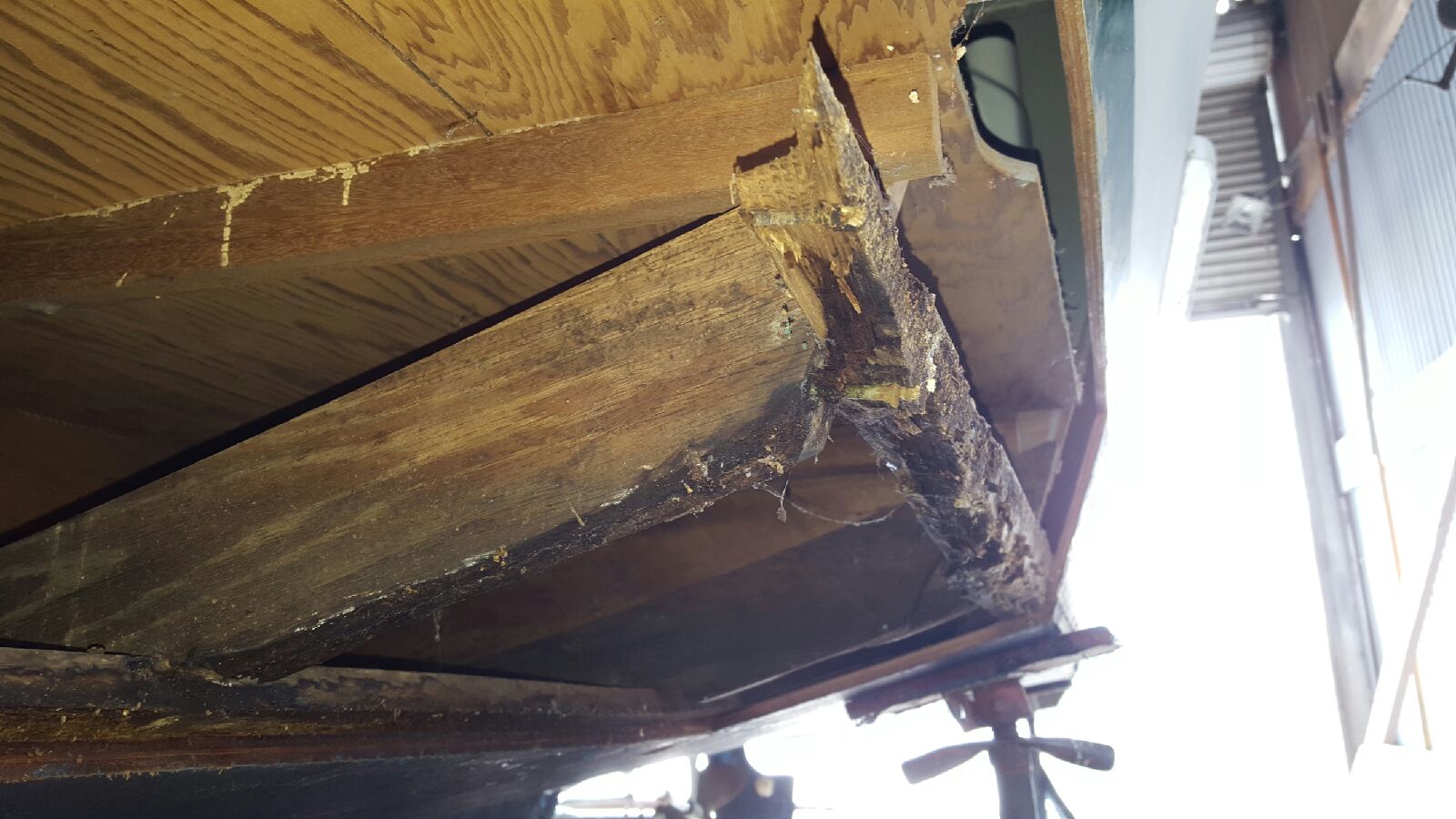

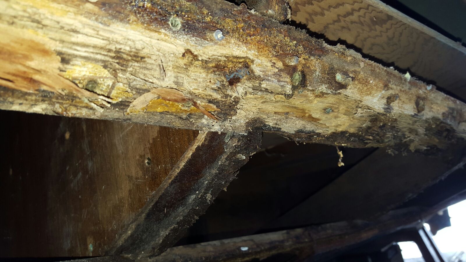

Now the fun starts. I tuned it all back up and it runs very well but water comes in at the chine for a while after each cruise. I had it scheduled to go in to Ramon at Diablo Boat Works at the end of this month. He had a cancellation so we took it over last Tuesday. Put it on an elevator and of coarse the first thing is they pressure wash. I stayed and wanted to see the initial suspected problems. As they were washing, the bottom paint which was less than two years old was just blowing off all over the place. The next thing was a bunch of Splash Zone filler jammed into the starboard last 4' of chine. Well we knew we would find something. Ha! I know usually you get a survey before buying but I thought being a Sea Breeze with the plywood hull couldn't be all that bad and we didn't pay much for her. Survey came back pretty clean except for some soft wood in the chine on both sides.
Ramon says about 20 hours plus materials to replace the bad wood. I didn't think that was so bad. We're going to have him strip off the house paint and repaint the whole thing since the repairs weren't all that much. More pics and info to follow.

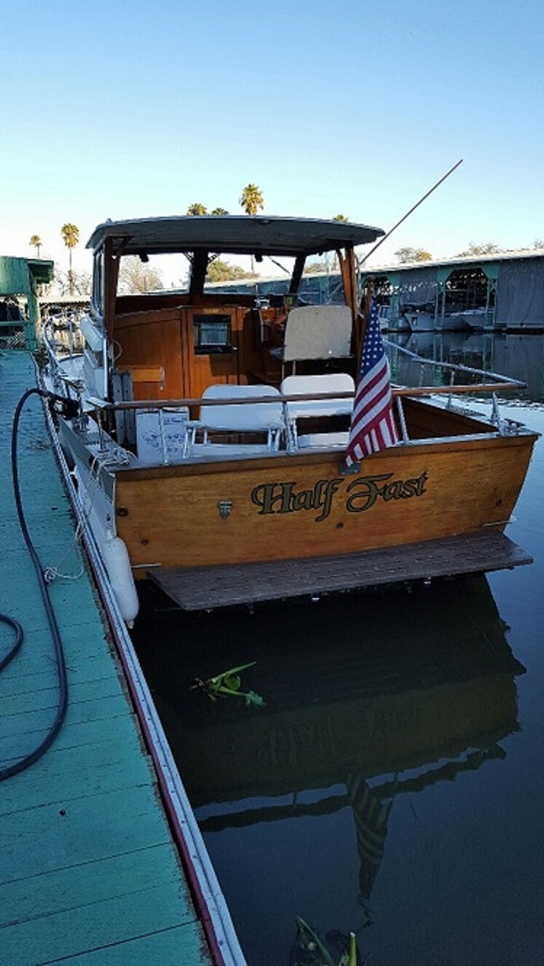

My wife came up with the name

The chine rots out on these Trojans and also on Shepherds because the chine itself wasn't angled properly to allow the water to continue unimpeded into the bilge. The water simply lays on the top surface of the chine. (I'm probably not telling you anything you don't already know). I have done chines in several wooden boats for this reason (especially Shepherds with roll down windows).
The rot spreads outward from the chine. The fact though, that the chines are showing wood rot doesn't mean the rest of the boat will necessarily be in the same state because the 90 degree chine was a design flaw. I will say this though, that when I had rotted chines I sometimes also had a rotted bow king board.

The twenty hours predicted by Ramon may end up being forty hours imho........ but still very well worth doing.
Possibly consider discussing with Ramon, the idea of angling the chine repairs to allow for freeboard water to drain unimpeded into the bilge.

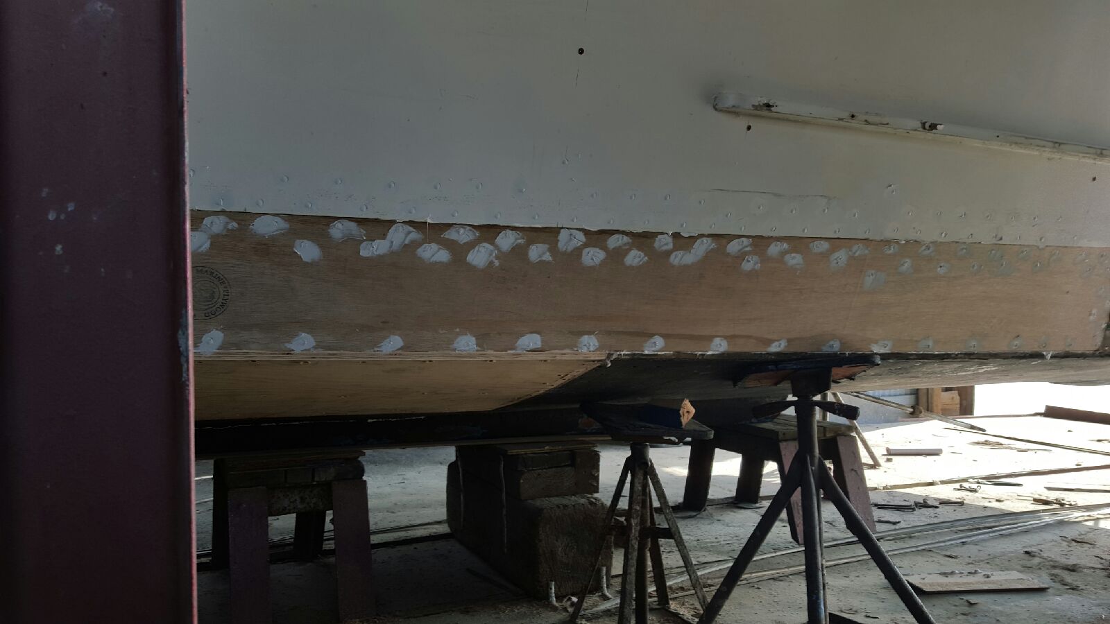

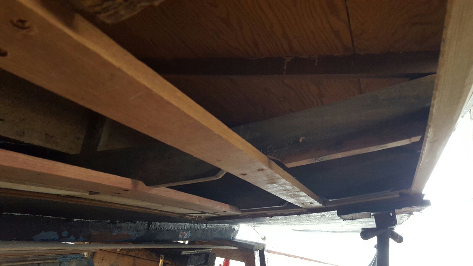

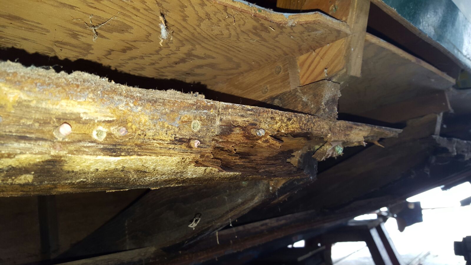

Re: 1965 28 Sea Breeze New Life

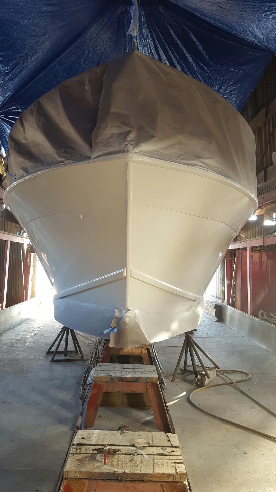

A few progress pics. You're right Rick, more like 40 hours. Had to find the end of the soft stuff
- 20160126_122630.jpg (139.02 KiB) Viewed 11651 times
- 20160125_162801.jpg (183.92 KiB) Viewed 11651 times
- 20160122_132141.jpg (135.74 KiB) Viewed 11651 times

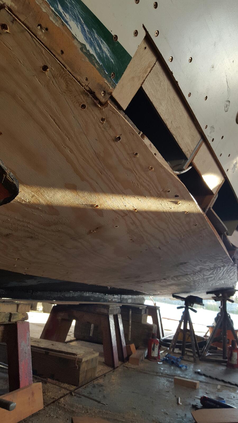

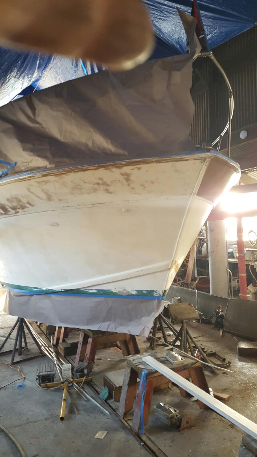

Getting closer. Two of these were today 1/27
- 20160127_160402.jpg (167.48 KiB) Viewed 11651 times
- 20160127_160354.jpg (168.69 KiB) Viewed 11651 times
- 20160125_162658.jpg (142.9 KiB) Viewed 11651 times

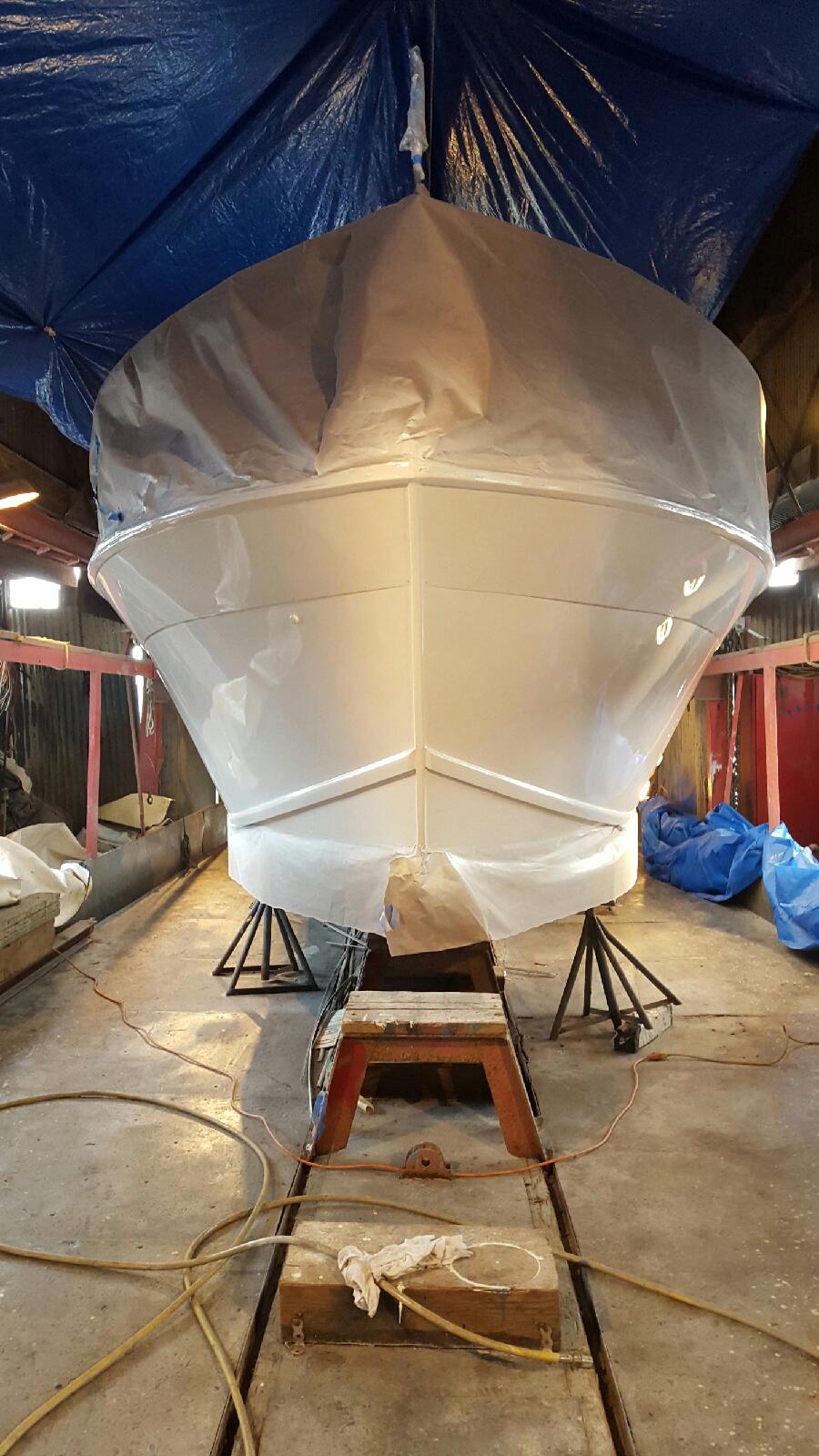

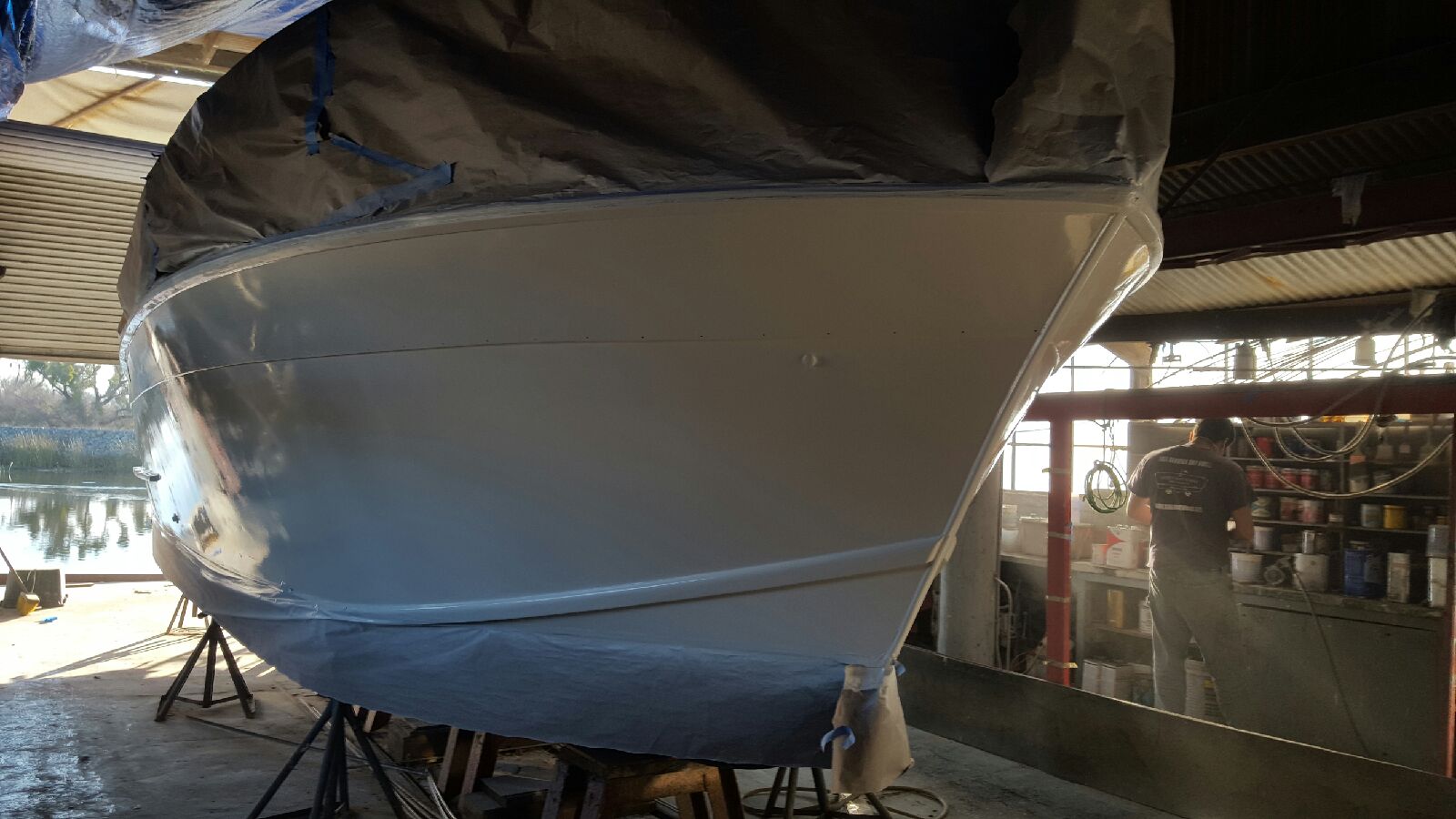

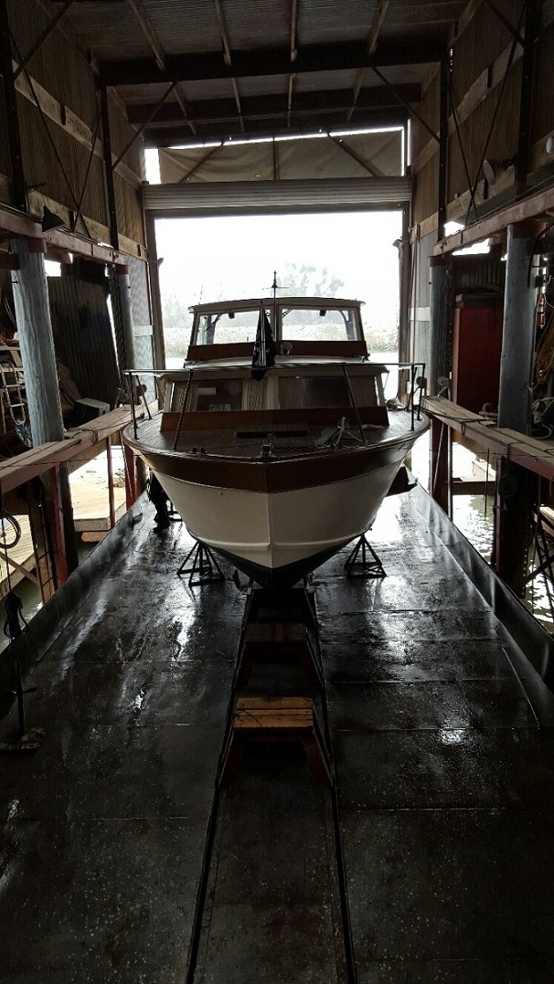

2nd coat of paint. Splash next Wednesday
- 20160129_141320.jpg (183.65 KiB) Viewed 11634 times
