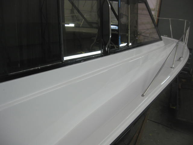

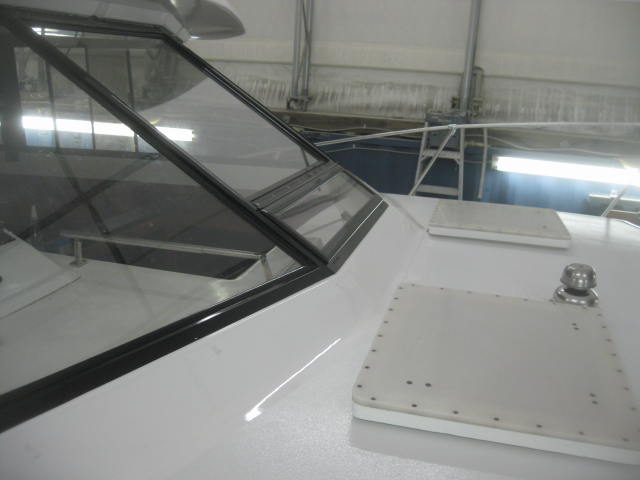

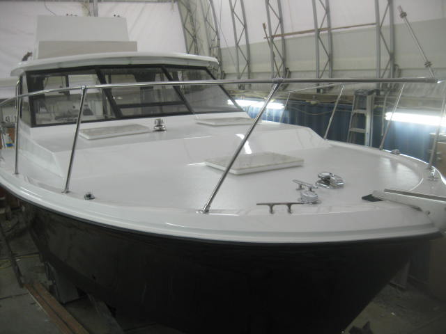

You might consider using a tintable spray bedliner material (ex. Raptor) then topcoating with high quality polyurethane (ex. Imron). I did mine 5 years ago and it is still flawless. It will likely last another 15 years. One great aspect is you don't have to do much fairing work, just grind the heck out of the existing surface with 36 grit, then spray the Raptor with the included 'gun' that screws right on top of the can. Then top coat it (wet on wet) with polyurethane with aluminum silicate non-skid added to make it shiny yet still non-skid. The products are available at autobody supply stores.

Your boat looks great. I'm surprised you can paint over a bed liner. I would think the paint would crack being over a soft surface.
