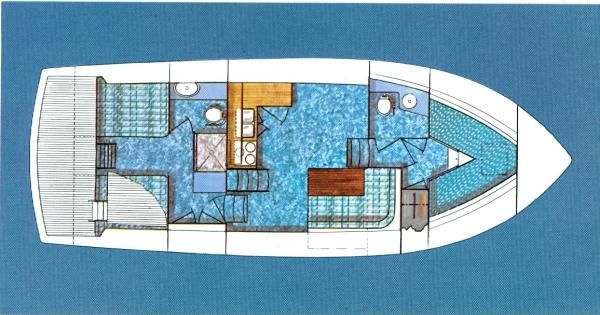

Hi guys,
Trying and flying here. Figuring out the aft filler cushion config is a challenge though. The PO supplied me with a cushion, but no "board"(what she called it) to span the walkway between the twins in the aft stateroom. Can anyone explain if this is a normal or custom config, how it works, and possible improvements?(PO described it as least comfy bed ever)

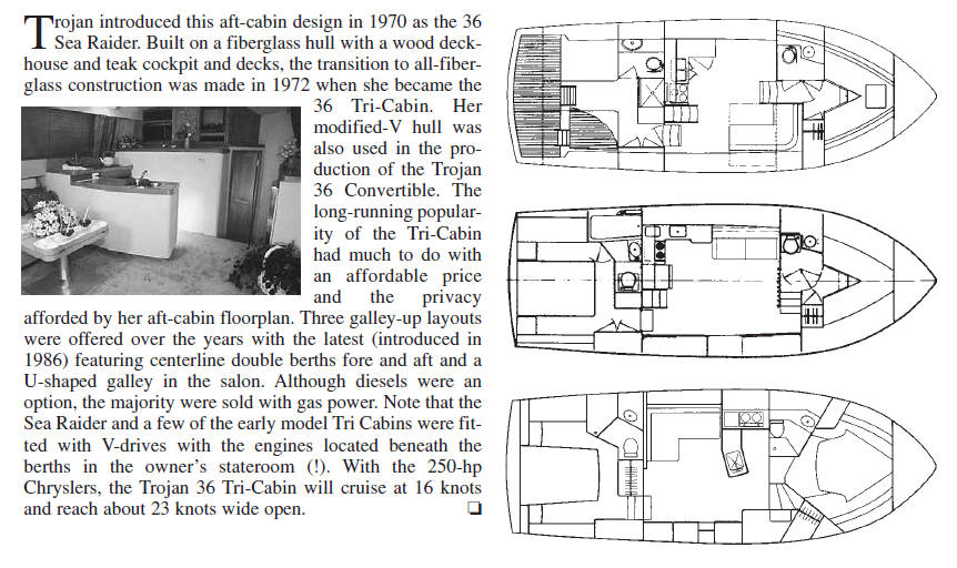

Tri Cabin and Tri-Fly are different layouts and superstructure designs, built on the same hull. The tricabin essentially has a raised mid cabin (salon area), with lowered forward and aft sleeping quarters (as you know); with only a single steering station - up top. The Tri-Fly is a 'flybridge version' of that, where the salon design incorporates a second helm station. And then the upper deck has a second steering station.larryeddington wrote:I am confused, is the "trifly" the same as the "tri-cabin'? My tri cab has a full bed in the owners suite.
Here is a tricabin : http://www.google.com/imgres?imgurl=htt ... kgodNIEEmA
Here is a tri-fly : http://www.google.com/imgres?imgurl=htt ... kgodNIEEmA
The layout Misty posted looks more like a normal tricabin layout than a trifly. The layout for the tricabin also evolved over the years (credit : PowerBoat Guide). By the way : built from 1970 - 1987.

Mine is the layout I posted. Engines under each aft bunk w V drives and NOT under the salon floor. There are a few online that customize this to some sort of super king size, but Id like a thoroughfare. May have to pull the trim and put my designers hat on. Stand back if that happens... My vision: A "Tricushion?"

Hey Misty, my tri fly has the same layout as the picture you posted, with the exception mine has a steering station at the "L" shaped sofa in the salon
