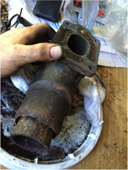

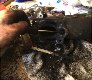

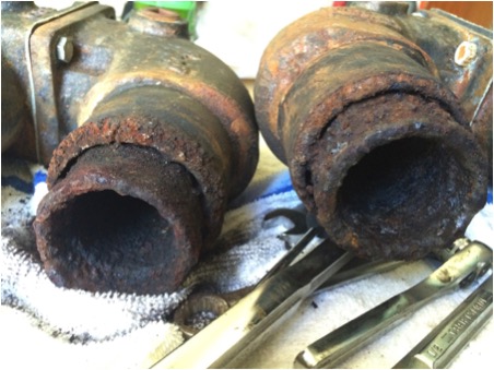

Then I rejected all advice. Slept on it. And reflected on the simplicity of the problem. With increasing back press and weak discharge obviously there is blockage. I removed the hoses at the exhaust manifolds and cranked the engine and water flowed fine. This meant blockage in either manifolds or risers. I reconnected hoses and used a temperature gun to measure hot spots and since I could see from one end to the other of inside the exhaust manifolds clearly it is the risers. Removed risers and sure enough, completely blocked off. I was still nervous about the cause of the steam (which I still don’t understand because it makes me think water is in cylinders) I cleaned out the risers best I could (the water jacket structures are solid). This took 2 tries because I didn’t do it well enough the first time. On second try I filled the ports with water and the water didn’t drain at all. So I cleaned and filled with water over and over until they were clear. See photo. I did this because I wanted to resolve the water flow issue and see if the steam was still present to determine the extent of damage in order to order ALL of the parts i would need. With risers clean the discharge is excellent and steam is gone. Thank god I don't have to pull a head or the exhaust manifolds aren't damaged. I ordered new risers for both engines and will replace them next week.

Photos of above description.
As removed
As removed
28- - 3.jpg (38.02 KiB) Viewed 10175 times
Cleaning
Cleaning
28- - 2.jpg (35 KiB) Viewed 10175 times
Water in ports that would not drain - at all
28- - 1.jpg (54.77 KiB) Viewed 10175 times
Man Cave
Posts: 11
Joined: Sat Jun 06, 2015 3:05 am
Re: Weak discharge with steam
Post by Man Cave »
I labeled the photos in the wrong order but you get the idea. Also, the second hose blew after I replaced the circulating water pump, not before. But it had nothing to do with the pump and replacing it was a complete waste of time and money. Anyway, hope his helps another person in the future and posts on this site have helped me so many times.

Although not the only possible culprit, the condition of your elbows are pretty typical causes of steam in the exhaust. The restriction causes fine streams or mist of water to be injected into the hot exhaust rather than large columns of water. The stream is easily burned off causing steam.
