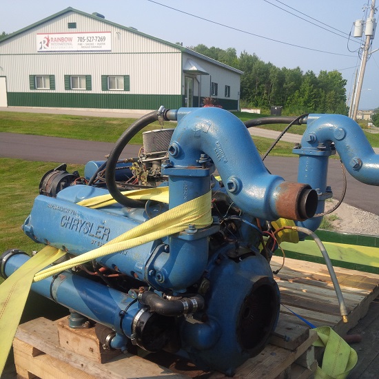

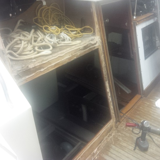

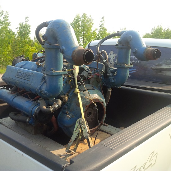

Hey guys, I think I figured out the pic size. Here are the 440's going in. The beginning of taking out the aft bulkhead for an easier repower. The 440's are 21/2" wider and higher. The Riser spaces are an easy removal.
Both engines were run up with Oil Pressure gauge attached
the door frame has been removed since this photo
Engines are as clean as the replacements.

Closed cooling Too. Makes them a bit tighter but great to have. :D
