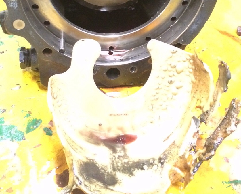

Ok I got it apart. It seems the very low oil level caused it to get a bit warm, well very warm and down right hot. Hot enough to melt the oil baffle as seen in the pic. The melted baffle was holding the ring gear from moving to the reverse position. So experts, is the baffle necessary? gonna try to find a new baffle, and already have a rebuild kit on order and will rebuild the unit since it is this far down, but Im thinking a new baffle may be harder to find. however the other existing parts still look like new.

I would replace it . You haven't pulled the clutch pack apart yet have you ?
Re: Velvet Drive replace rebuild?
Found one on Ebay, so yes, Yes, clutches are all out waiting for the new set. Hope to get it all back together next week. All parts look good yet, just the melted baffle.

Wow, parts came in in two days, slapped her back together and did a bench test. Used a large hand drill that would turn in reverse connected to a genuine redneck high pressure hose adaptor. Got enough rpms to actually shift, but going into reverse put a good load on it however it would shift into reverse fine. Had to slow it down or the drive would have spun over. Must create more resistance in reverse?
In neutral, the reducer still spun so a little concered about that. Going to hook it up to the engine tomorrow and see what we have.... Wish me luck.
