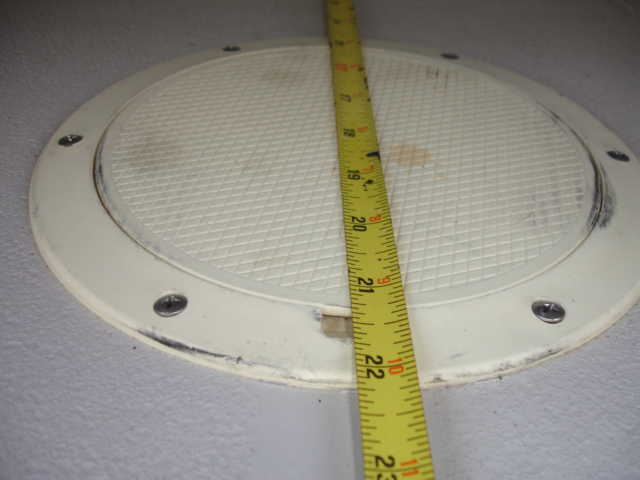

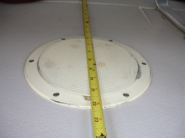

find a new mechanic who is capable of thought.
One of the first things I did when I bought my boat 14 years ago was to replace the fuel sending unit.
I simply located the unit on the top of the tank and cut a hole in the deck in order to install an access bung.
Let's see if I can locate a photo for you.
Re: 1987 Trojan 10.8 Meter Fuel Gauge Sender Issue
note that the end of the tape measure is against the aft side of the cockpit floor, on the interior.
also, the photo & measurements are for a 1983 10 meter EXPRESS

+1 on cutting an access hole.
keep in mind that the aft deck is BALSA CORED.
Care must be used to PROPERLY SEAL the new hole when installing the new bung/inspection plate.
Also, I learned that a WEMA style sending unit is a far better choice than the technology used by the factory.
