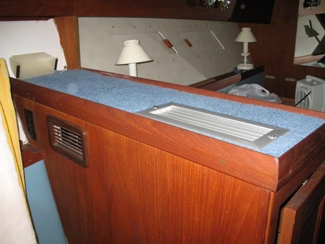

Re: My 84 10 Meter International

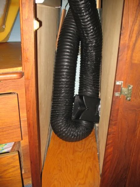

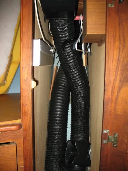

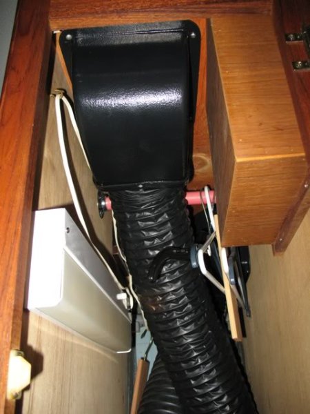

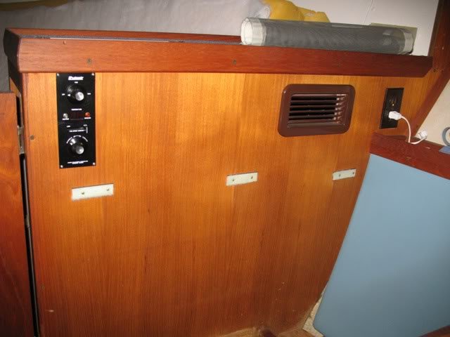

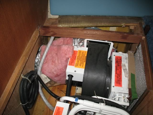

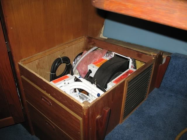

My boat is a different model, but this may give you some ideas. A/C in mine is under the forward dinette seat, and ducting runs through the forward hanging locker. We lose the storage under the seat, and most of the hanging locker. Here are some pics
The A/C does a good job of cooling the lower cabin, but the salon area of our F32 doesn't cool very well (with cold air falling, the salon doesn't start to cool down until the lower cabin is full of cold air, then with all the glass up top it's a bit of a fight, or if we have the salon door open we lose the colder air right out the door). We normally end up with a fan on the dinette table or galley counter top to try to push cold air up to the salon.
