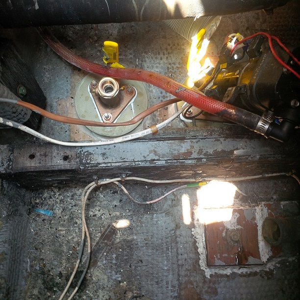

I have this to deal with. A completely rotten rudder support on the port side.
I read somewhere that the wood used was White Oak. Can anyone confirm this?

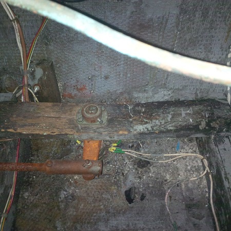

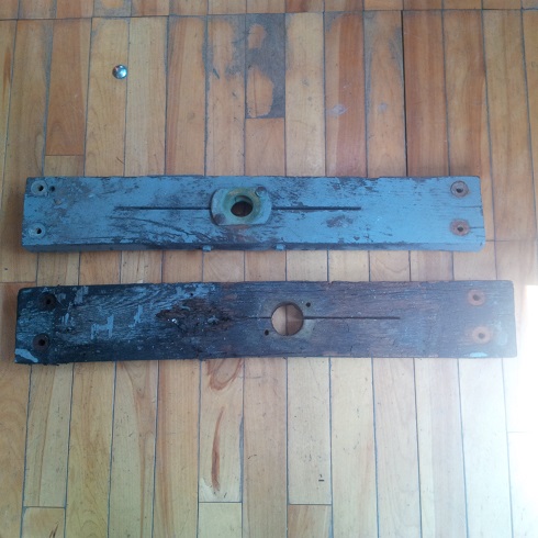

Hi Guys!
I got to remove the upper support today! Not to difficult. I measured the angles of both rudders and supported them as well before removing them.
As you can see, they were in bad shape...

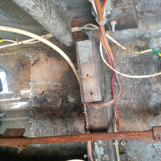

As a feared, I did open a can or worms! The aft portion of the wood supporting the rudders is rotten. The section supporting the engine mounts is OK but a few inched behind that, they are shot... Not sure what to do here.
I am a bit surprised at the way it was built. It is a piece of wood sandwiched between the sheets of 1/4 plywood. not sure why this was done. Anyhow, I don't have a lot of options here. Either remove the engines and replace the complete kit on both sides or splice new pieces in-situe. or finally, beef up the sections with aluminum channels on both supports.
The support pictured above is the least rotten.
Any thoughts?

Where are your motors located that are worried about them? They should be under the salon decking which is 12' away from there. If you have the rear fuel tanks sitting there, you may have some problems.
This is a classic stringer repair. You can basically dig out the bad wood until you hit good wood, then go another couple of inches. Use a scarf joint and epoxy a new piece in there, then re-glass.
todd brinkerhoff
Posts: 696
Location: Finger Lakes, NY
Re: Upper Rudder Support Replacement
Post by todd brinkerhoff »
I second digging out all the rot, and then cpes the existing, and then fill with a scarfed piece or use some of Smith's building epoxy. You can certainly reinforce it with aluminum. And, FYI, you're doing a great job. I love to see Trojans brought back to life by capable people.
