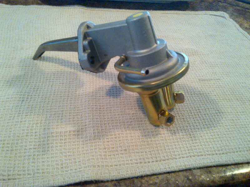

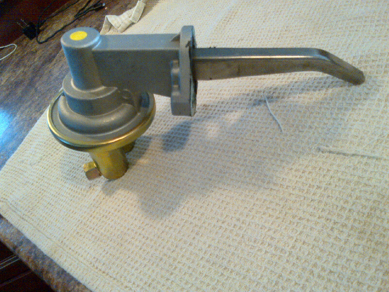

Heh all, does anyone have a source for a good quality mechanical fuel pump......here is a pic of the one I just removed today, lasted about 20 hours....the originals say made in the USA on them and are much heavier....Thanks Mike

How did yours fail? I replaced mine 2 years ago and again this spring. Both the same one as you have. My first one was leaking at the flange where it folds over on the aluminum upper. The hose to the carb didn't pull the leaked fuel into the carb like it was supposed to either. I noticed on my newer one that the two lower stand offs where the fuel lines attach were parallel to each other. The older one had the standoffs angled towards each other, like they were bent wrong. Your pic looks like yours might be bent too?
Anyway I'm hoping the parallel version will last longer.....a LOT longer.

Scorpion07 wrote:How did yours fail? I replaced mine 2 years ago and again this spring. Both the same one as you have. My first one was leaking at the flange where it folds over on the aluminum upper. The hose to the carb didn't pull the leaked fuel into the carb like it was supposed to either. I noticed on my newer one that the two lower stand offs where the fuel lines attach were parallel to each other. The older one had the standoffs angled towards each other, like they were bent wrong. Your pic looks like yours might be bent too?

It failed because the inverted flare on the discharge side was not the same spec as the pump I took off (height and loose threads), and the fuel line did not want to seal,couple of repair tries by me but finally gave up.....why do we pay for these cheaply made,poorly engineered offshore pieces of crap and then have to re-engineer everything to make it work......there is a noticeable difference in weight between the old one that I put back on and that one in the pics...cast aluminium versus the thin stamped steel legs that are very weak....anyway that is my rant for now and lets keep looking, i need a spare....Mike
