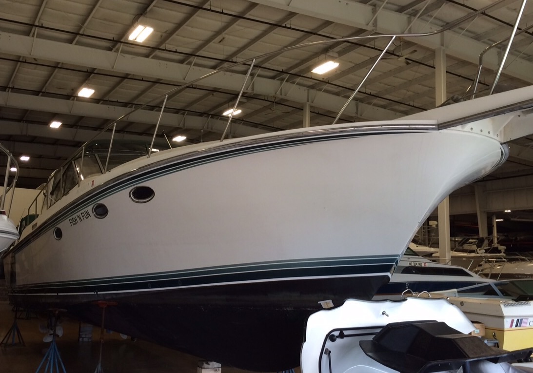

Just picked up a 1988 11 Meter Express. And stumbled upon this site. Impressive.... :D I am going to give this boat a once over. Needs a good polising, and some minor repairs, but next year the transformation will begin, but for now just the start. 454's got 1450 hrs, and mostly fished, so I will do compression test and decide if my winter project is a dual rebuild. For the most part given its age, it is not in bad shape, minor moisture found during inspection, but needs some new seal work.
Few questions for the experts:
How do I remove the old name? (Painted on).. Daughter wants a new name.
Can the non skid deck be waxed (potential dumb question)
Previous owner used the slip posts a lot (brail docking) so the rub rails are pretty banged up. Where can I get replacement metal?
Anxious to splash her, but need some love. It is a boat after all right? Any other suggestions about this boat are welcome!

Pictures of a boat still on the sticks just is not right. Ill post some as soon as she is wet. But this will do for now
1988 Trojan 11 Meter Express
