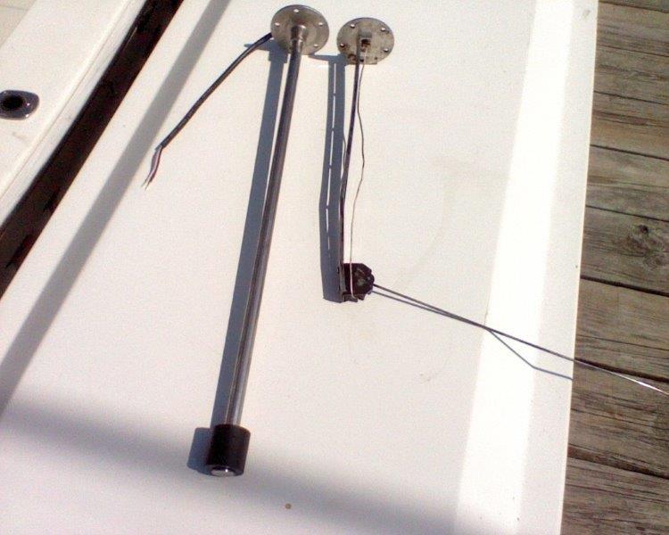

When I replaced my senders I up graded the senders to wema senders . They are now dead on . much better then that swing arm junk

Re: Help with Fuel Guages
Wema to the left junk
(swing arm ) to the right .
