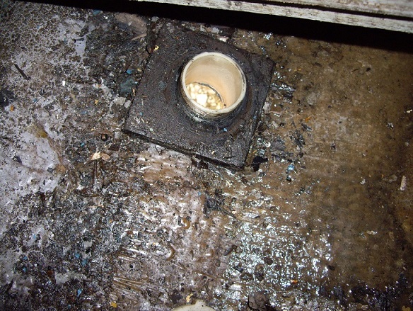

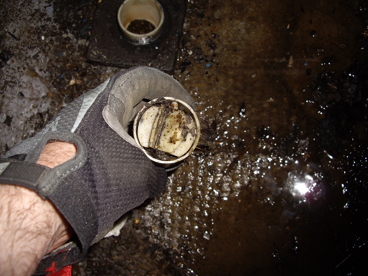

First I removed the engine raw water seacocks. One was loose but as it turned out was the most difficult to remove :shock: The backing plywood plates were a joke to remove. All of 10 minutes.
Here is the starboard:

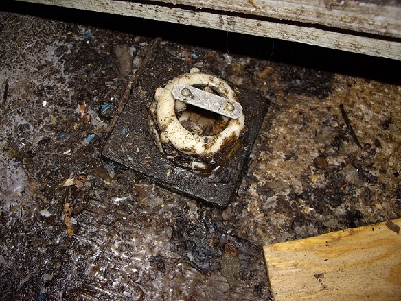

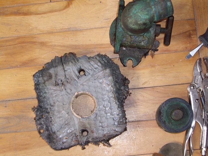

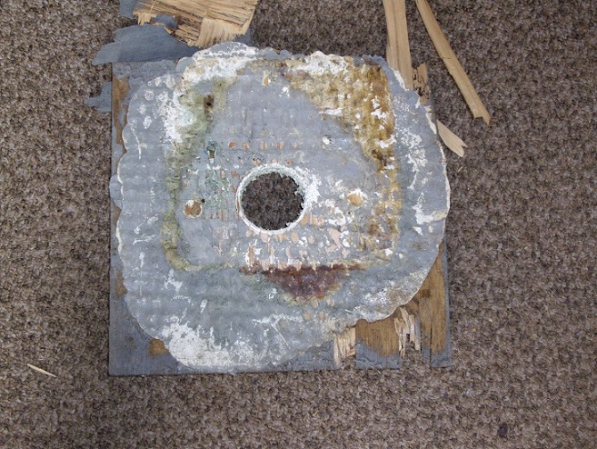

And the backing plate:
Then for the post side:

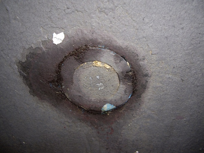

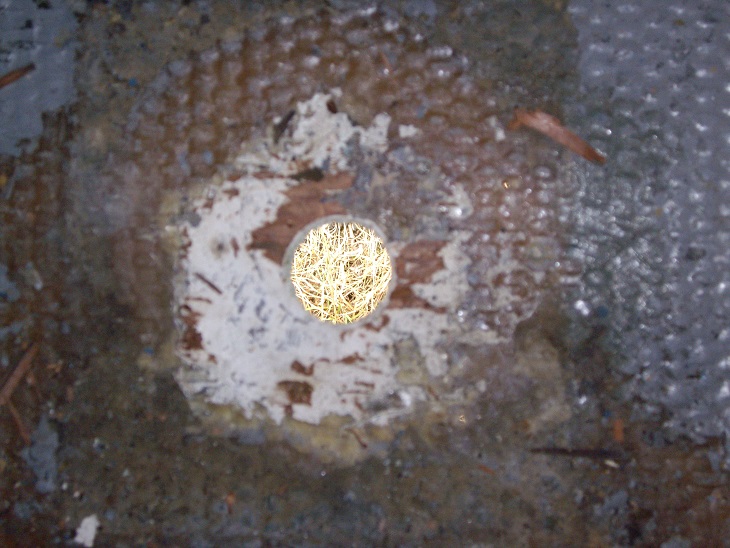

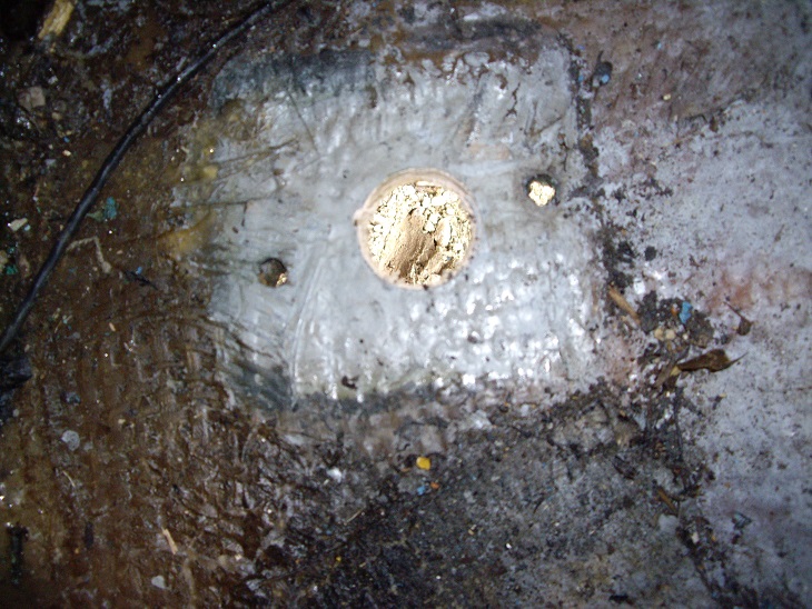

I then tackled the mysterious plug...

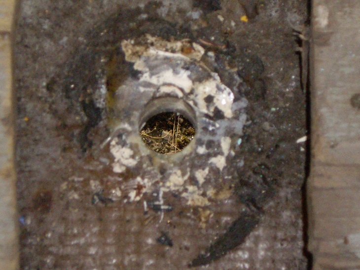

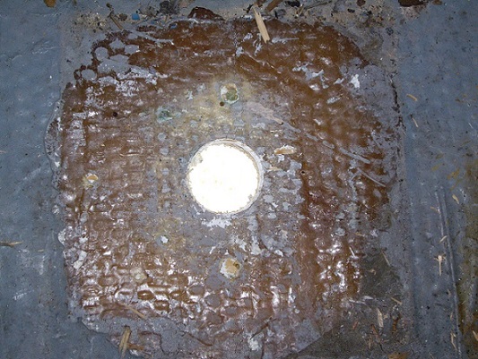

While in there I found this hidden gem. That must have been in the hole originally!
Looks like the speed transducer...

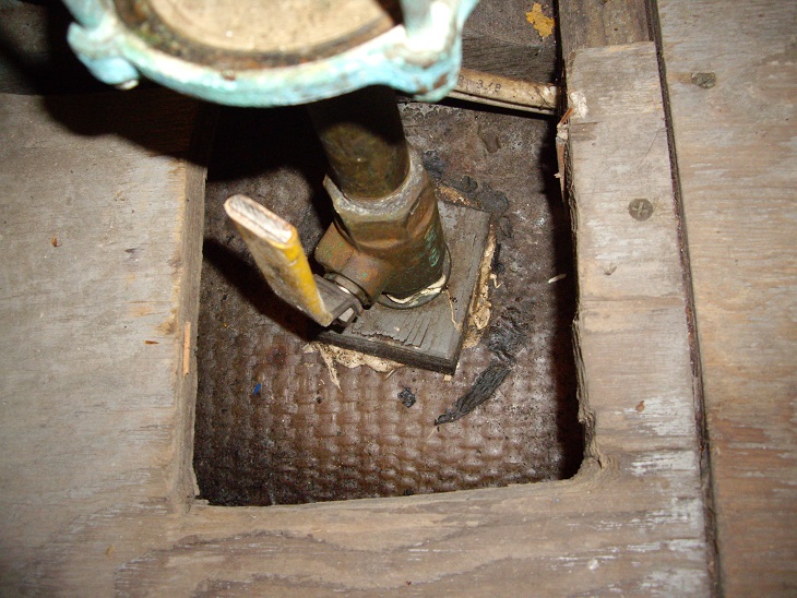

I then went on to an orphan seacock that was not attached to anything. I believe it was originally for the AC unit:

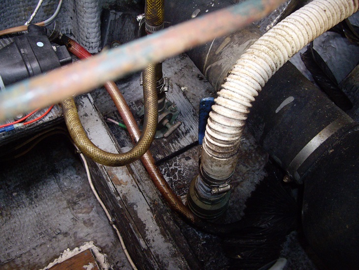

Finally, I hit the raw water for the Genset:

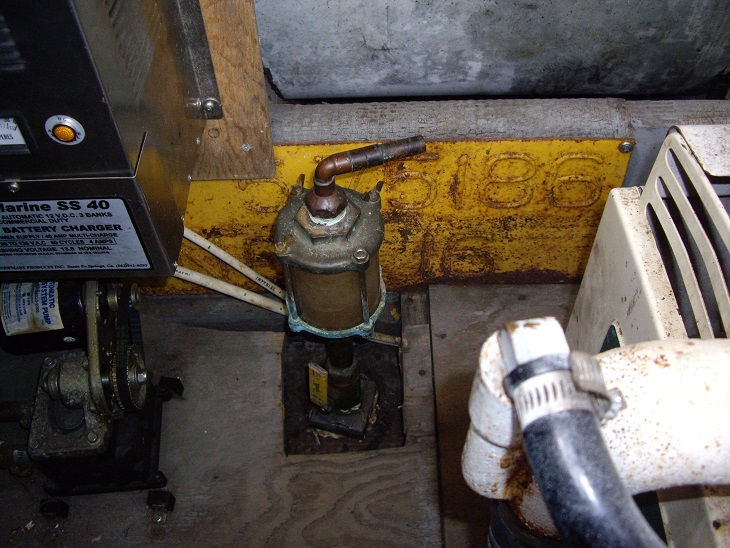

I found this yellow plate in the generator room! Does anyone else have this?

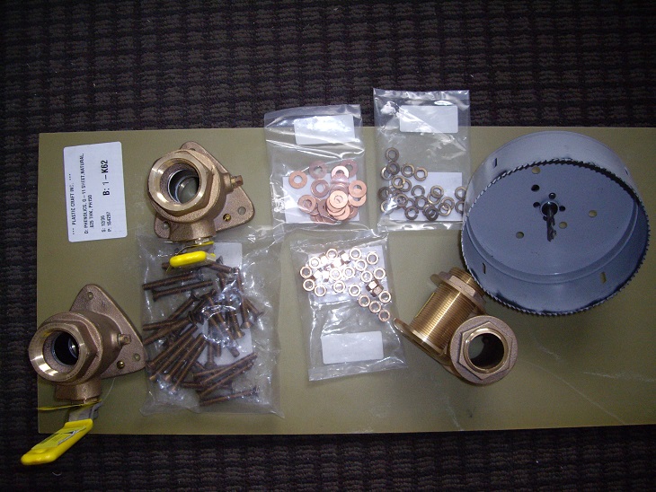

Here is the new hardware for the engine raw water seacocks. You can see the G-11 sheet in the background. Very similar to G-10...
All proper silicon bronze hardware and this big a## hole saw :shock:

The yellow plate may be a Documentation #. You can check to see if it was documented and the vessel name at
http://www.st.nmfs.noaa.gov/st1/CoastGu ... yName.html
Christian
Posts: 129
Location: Ottawa Ontario
Re: Seacock Replacement
Post by Christian »
Sweet! You were right. I found it. What would be the purpose of this?
ready123
Posts: 1841
Post by ready123 »
Christian wrote:Sweet! You were right. I found it. What would be the purpose of this?
Documented boats must have the number physically attached to the inside of the boat. If the boat is no longer documented it should have been removed.
Michael
Done Dreamin'
bjanakos
Posts: 498
Location: Richmond, TX.
Post by bjanakos »
It does not need to be removed. In fact, the coast guard states that document number be affixed in a way that they can NOT be easily removed. If you ever decide to re-doc your vessel, it may be easier to renew the expired doc than start all over with a new doc.

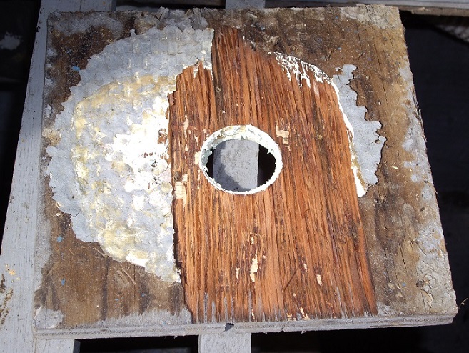

I started cutting the fiberglass plate the big hole saw. Well that was a fail. I was not able to go through the whole thickness before to saw wore out :shock: this stuff is hard as a rock. I don't think it was a bi-metal hole saw. Now I have to figure out another way or get a better one. Will see. I will post a picture of the setup to cut the plates tonight.

I did mine on a band saw. I made a circle cutting jig for a previous project. It's basically a plywood platform clamped to the table with a 1/4 dowel.
Where you using a drill press with that giant wheel?

I basically chucked it in my milling machine...
