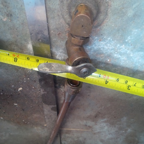

Hello everyone . On f25 has anyone replaced fuel check or non return valve ? if so do you know how to size em as having difficult time finding one to fit .Basicly would like to stop gas from draining back to tank after sitting for cpl weeks
fuel line
fuel line
Re: Fuel non return valve
I think what you're looking for is an anti-siphon valve. Used primarily as a safety device to prevent siphoning should the fuel system develope a leak anywhere after the tank but will do the same thing you're enquiring about. Looks like you may have a 3/8" line.
