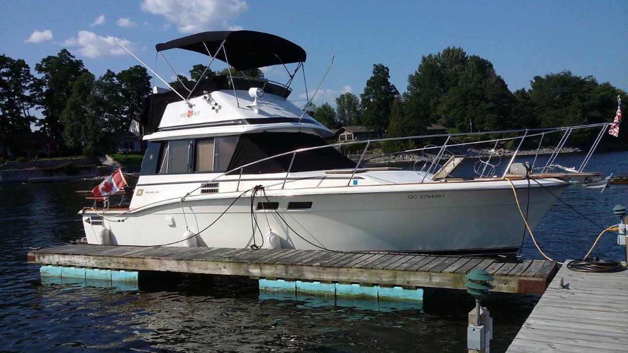

Thought I'd start this as a different thread.
Mine is a 1979, but it is a late 1979, the boat came off the line in late November 1979, and was shipped to the first owner in February of 1980. So in my books, its a 1980 model year if you will.
It is true, vent placement was changed after the Sea Mar tragedy, and the forward vents moved off the hull and I'm not certain if the aft vent direction was altered. But as other boats have the same configuration, I believe it to be accurate and dovetails with the original documentation I have.
Some asked for a photo of the full boat - here it is
George P
1978 Trojan F32 "Defiant"

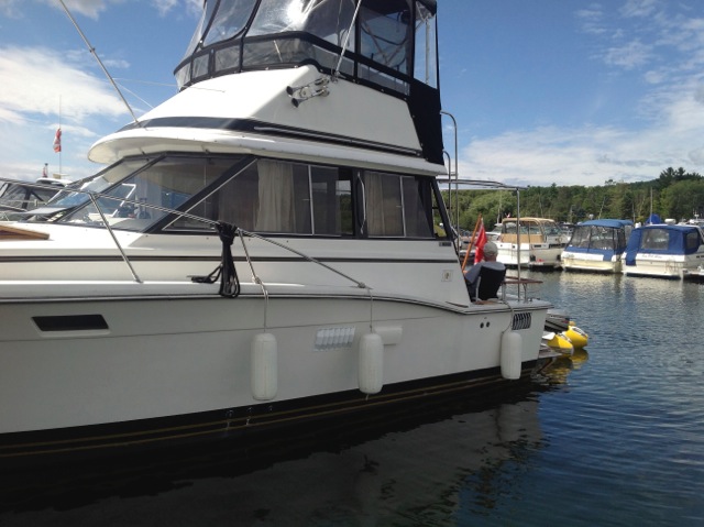

Yes that is different from mine and ready's, ours are 78's , when I saw your signature with a 78 f32 that is what caught my interest with the vents......I have often thought that your year boat on up has the much better vent setup to the 78 ...Mike

georgepet you do not have the same style vents as Sea Mar did, the boat below, mikeanddanne does as do my two Trojan F32's, and for the record his and mine all face this way, this design was later changed to what you have to prevent taking in water in rough seas

k4282 Tell me something ,my aft vents have a block off plate o the inside that covers about 2/3 of the lower part of the aft vent..I think you can just see it in the pic......wonder if yours are the same and was this an early fix or just original...Thanks Mike

Mike, mine is a 1975,delivered in 76 my rear vents face forward and have the same block off. slanting front to rear. I can not attest to this being original or modified as we have only owned for 3 years.

I have a 78 also and have the same area blocked off at the bottom of the rear intake vents. I assumed that it was to prevent water from entering. Having read about the F32 that sank, I installed a 3500 gph pump with an auto switch in the lazarette, just in case. I have thought about reversing the vents so that the rear vents faced aft and the forward vents faced forward. Has anyone done that and if so, how has it worked out? With the forward vents being higher up, they may not be as likely to take on water.
