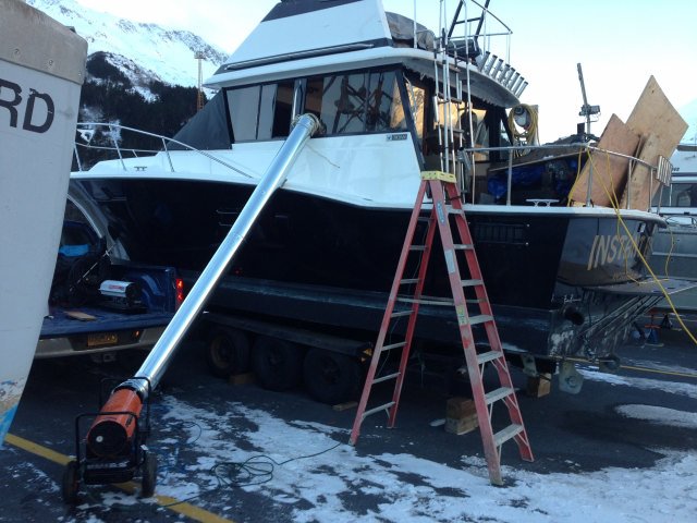

Posting one image of each day in the process. Each 'day' consists of driving an hour each way to get to the boat, attempt to thaw the boat when I get there, and getting four to five hours of actual work time each Day. Today's weather is typical but a little warmer than usual. Check out the gusts. It was rockin' the boat on the trailer.

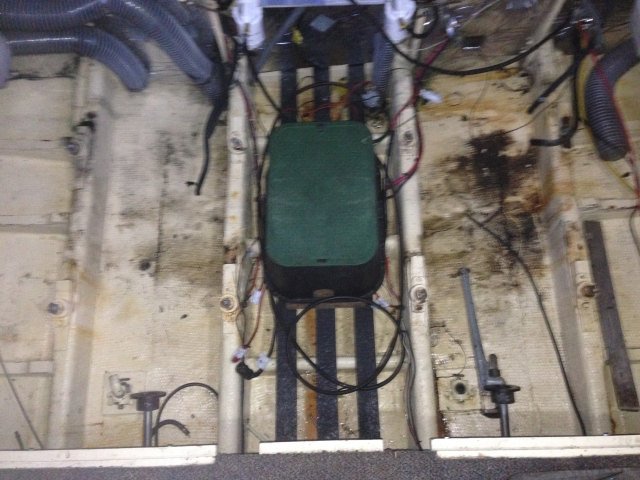

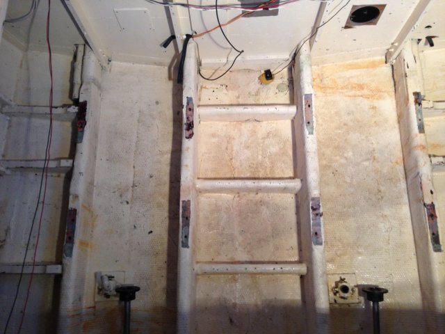

- Day 4 - Dewiring complete
- DAY 4 (6).jpg (55.37 KiB) Viewed 11895 times
- Day 2 - engines out
- DAY 2 - ENGINES OUT 6.jpg (66.41 KiB) Viewed 11895 times

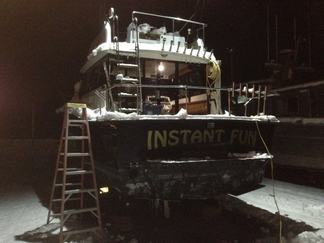

- Day 1 - Getting organized but dark at 4:15 p.m.
- DAY 1 DEC 20.jpg (56 KiB) Viewed 11895 times

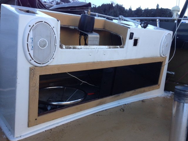

Day 5 - For some reason I could only post 3 images when the topic was started. You can't tell from the picture, but the wind is screaming. It has actually blown all the snow away.
- Invisible wind - gusts to 60 kts and cold
- DAY 5 (5).jpg (71.45 KiB) Viewed 11893 times

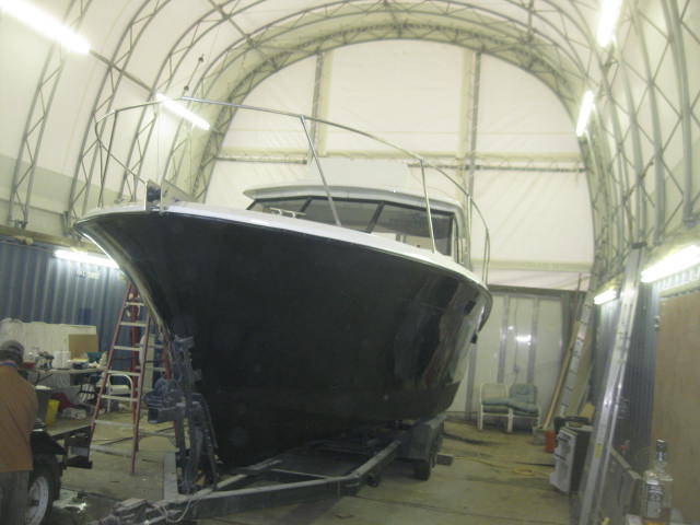

- Day 5 - Almost ready for paint
- DAY 5 (9).jpg (57.21 KiB) Viewed 11893 times

I take it you've sounded the stringers and bulkhead? Moisture readings would help too.

I pounded on them, and found no softness anywhere. Everything appears solid. Unfortunatley, moisture readings ain't gonna happen this year.

Love that you are taking on such a huge challenge. Know that you are in the REAL great white north, but indoor, or indoor and heated storage are not an option? With the amount of money you are about to spend and work you are about to do, getting the boat in to an environment more conducive to that has to be possible. The results of some of what you are looking to do is very temperature dependent... Work done under the wrong conditions tends to lead to re-work...

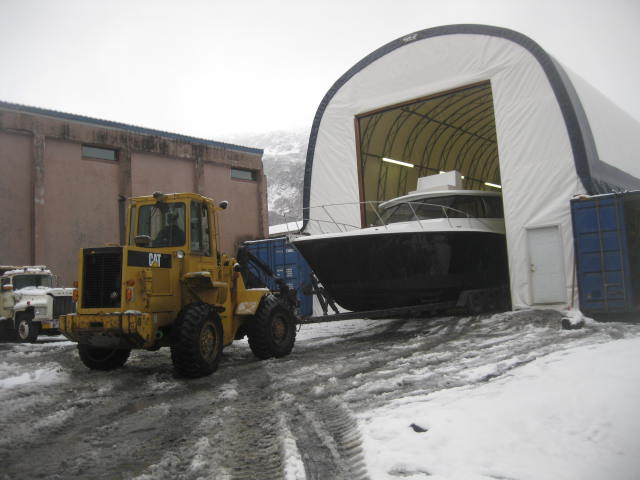

Problematic as the temperature and weather is, it's still doable by heating just the areas where I'm working. There is one structure in Whittier that I could rent. It is a quonset stlye tent set atop 40' conex's on 3 sides. When I painted the Instant Fun four years ago, it rented for $2k/month and it cost almost another $2/k for diesel to heat it with space heaters. Also, it would put me in more of a rush than I want to be in.
- DAY 31 (17).JPG (53.79 KiB) Viewed 11887 times
- DAY 31 (2).JPG (53.65 KiB) Viewed 11887 times

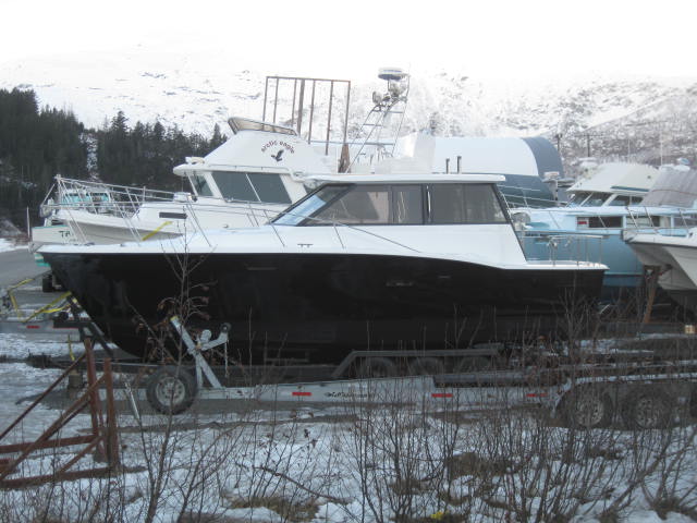

hello i was wondering if you had any side profile pictures of you boat instant fun it looks like you have the fly bridge off I have been looking for a pic of a f36 with the bridge removed for a long time i want to remove mine but i am do not know how the lines would look

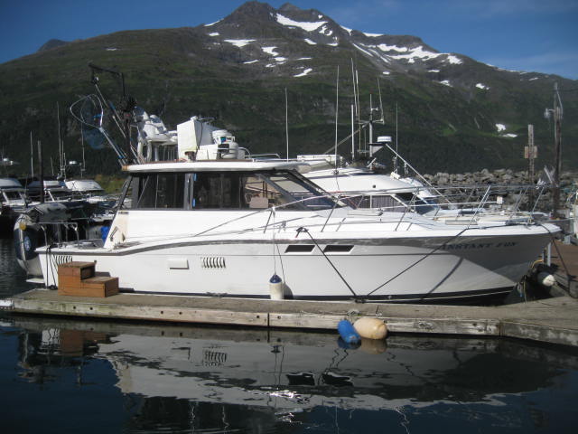

Looks kinda cool w/o the flying bridge, but I love the upstairs on a pretty day.
- NEW PAINT (2).JPG (68.25 KiB) Viewed 11659 times
- flybridge removed (38).JPG (66.06 KiB) Viewed 11659 times
