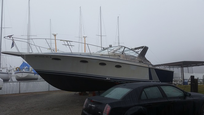

I bought the boat. The damage was only on the surface and did not affect the structural rigidity at all. Mechanically its in top shape. I had it dropped at a paint and fiberglass facility this week and pulled the cockpit interior yesterday. Glass repair starts Monday.
Cockpit interior gets to the upholstery shop this week as well as the cabin cushions. My granite guy is heading out there this week for the counters. And lastly the cockpit and cabin flooring should be decided on and ordered this week.
I am going to refinish her and keep her going. My search for the curved port side windshield window has begun and I will contact some glass repair places tomorrow.
I will likely have to start a thread, but any ideas on how to remove the teak on the transom and gunwall? Do I have to
drill out the teak screw plugs or is there a trick from the underside? The wood is gorgeous but is in need of a complete strip and refinish, its has years of oil build up.
Brandon
trojan resize.jpg (70.71 KiB) Viewed 18345 times
Here's a photo of her on new years eve.
