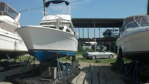

Looking to find some reasonable information. 1972 F31 flybridge with twin 233hp ford 351 mercruisers. Cannot seem to get 4000 RPM, only getting 3000. Where it stands now, I'm assuming improper screws. I currently have 14x14 installed.

- image.jpg (51.66 KiB) Viewed 5089 times

Are you a Dandy Haven ? It looks like it in the photo , I may know your boat .

I am at Dandy Haven. And correction to prop size. They are 16x16. And reductions are 1.52:1. Guessing the boat ran aground since the port strut is bent. After looking back at pics, I had one with the stamp of 16x16. These cannot be the original props for this boat. Let alone the correct size.
