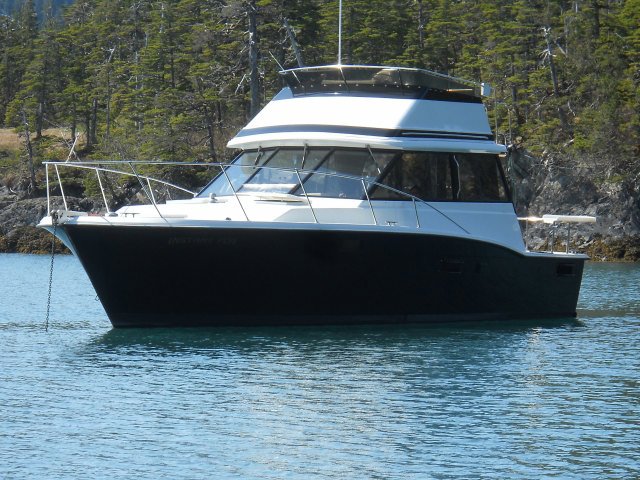

Hi Guys,
Long time, no talk to. I hope everyone has been well.
I'm finally gonna repower this winter, and am considering used diesels vs. new gas.
Does anyone know off hand what diesels have been installed in F32's, and with what results?
Thanks,
Dave Lofland
Thanks,
Dave Lofland

There have been several I know of on here . Rossjo has Cummins 6 BTAs in his . JAV put Volvos in his ( 200 HP each TAMD41-B). I believe Both are happy I believe JAV wishes for a little more power . There is another F32 owner with I believe Perkins in his , this boat is not fast and is use at trawler speeds but the owner loves it . I have seen a few on the market one with a pre/early 3208N cat and one with Mercruser diesels ( not a good choice IMO ) it was under powered . Some of the Discontued Yanmars maybe a good choice , not a fan of the new VW based Yanmars .

The 6BTAs in my F32 will run 27knots (31mph), and the fuel economy at idle speed is unreal (1:1 Velvet Drives with 17x20 props) at 8knots idling.
Great setup and the Inline-6 config is easy to work on, but barely clears floor. Paul's is probably about the same clearance.

As I research options, the 6bta's are recommended more than anything else, plus there are a lot of them out there.
Regarding the 8kt idle, can you slow that down with trolling valves (for trolling). We have to get down to 1.8 - 2.1 kts to troll for King Salmon.
Do you guys happen to know the 'down-angle' of the gears?

Just pulled the trigger and ordered a pair of new Yanmar 6by3-260's with ZF 1.51:1 gears. All electronic controls. N2K output.
