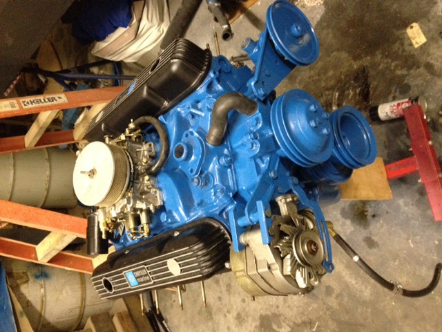

With all the advice and help from the Trojan Forum, here is the starboard motor just about ready to come off the stand. It's a new long block with the old parts and a few new parts installed.
Thanks Guys!

Good stuff, Jim,looks good, one thing I always enjoyed was putting engines together then hearing them fire up, lots of satisfaction there.
---like the valve covers ,never seen ones with chyrsler marine on before---Mike
- Posts: 1876
Re: Engine rotation
I have some aluminum plates that go on the exhaust manifolds that state Chrysler. They are a copy of an original I had and a graphics guy made them. But as you said never seen the Valve Covers even on the Super Bee version. Something new and neat. I paint mine in black crinkle paint.
The ones shown here are way cool.
