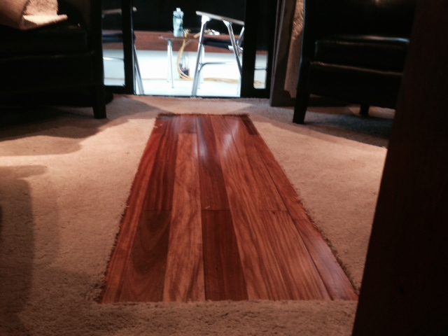

Yes, I actually use her for pleasure, so I bought a remnant and cut and placed it in. I built the hatch top out of wood flooring, and then cut the carpet so I could open the hatches if needed. That was in the salon. In the lower area of the cabin, that is a solid piece. Let me send a picture.

Cmount
Posts: 166
Location: Norwalk, CT
Re: Replace Carpet / Refresh Woodwork
Post by Cmount »
pic

Thats very nice. I like it.
What do you do if you need to access to the entire engine? Does your whole carpet lift up? Or is your carpet cut around the large panels?
I am thinking of of cutting the carpet and tacking it down to the large panel doors so I can lift everything out and pop it back in.
Cmount
Posts: 166
Post by Cmount »
I cut the large hatches in as well and used snaps to hold the carpet in place. I also put hinges on the hatches so I can just tip them up.
