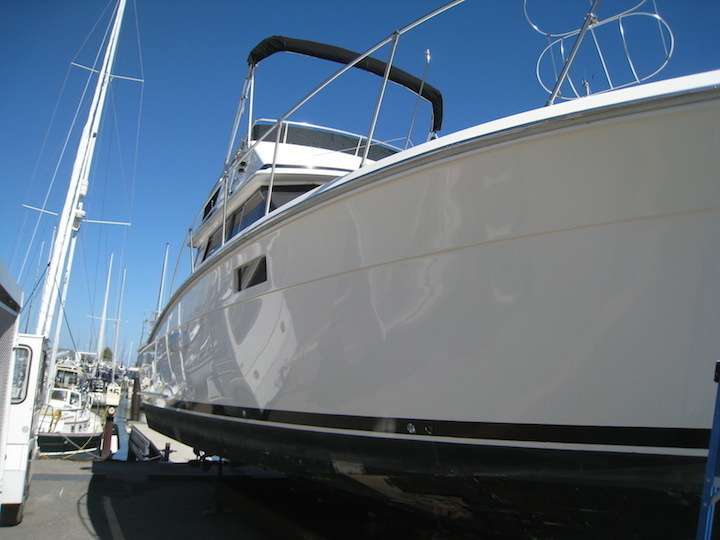

- gelcoat looks good
- IMG_0284.JPG (99.11 KiB) Viewed 5814 times

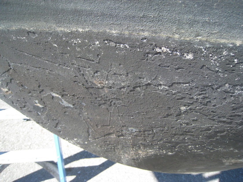

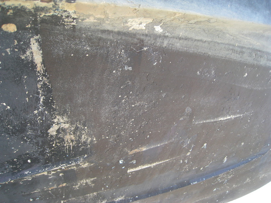

- this isn't to bad
- IMG_0285.JPG (230.37 KiB) Viewed 5824 times
- this is the bad part up towards the front of the bow
- IMG_0281.JPG (228.67 KiB) Viewed 5824 times

First of all I have to say - I (almost) hate you. That gel looks AWESOME!!!! What year is it? With that gloss and reflection, is that original gel or has the boat been redone? I thought my '79 looked great with the right polish and wax, but holly crap!
Re the bottom - really depends on what kind of water you are in, and what's going on with the bottom. You didn't say anything about if you were in salt or fresh water (that changes things), or if you have osmosis or blistering problems, or what kind of antifouling you have on there now. All of that affects what 'treatment' you might need. If 'they' want you to leave it over winter to "let whatever water is there to dry",that suggests osmosis, but I don't see that in the pictures.
The pictures don't suggest you have a huge problem (the last one suggests many layers of a potentially hard/leeching antifouling, but nothing I haven't seen in 20-40 year old boats), so just wanna understand (as does everyone else on the forum) your world a bit more to figure out what makes sense, or if 'they' are trying to take advantage of you.
(I redid my bottom a few years ago; special stripper system (that failed), followed by manual scraping and sanding (60 grit); then repaint with 4 coats of Interlux Micron CSC. Total investment (including failed stripping system) - 100 hours of my time + costs. Had about 35 years of hard antifouling buildup on the bottom)

The boat is a 78. They have her uo on blocks and the boat looks beautiful.Classic lines.I was thinking of replacing the splash rails with teak?
That build up is only in the from part of the bow.

here are some pics-better pics.
I took a long time to buffed her out last fall. Still looks good.
