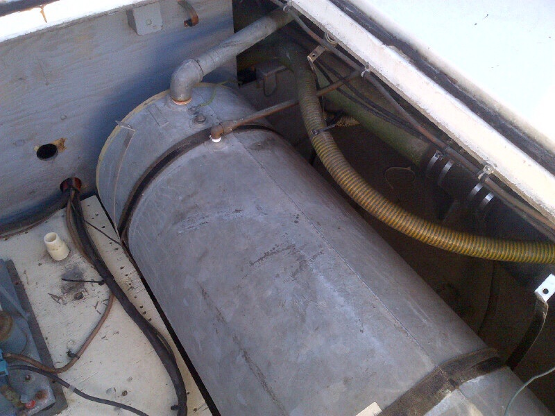

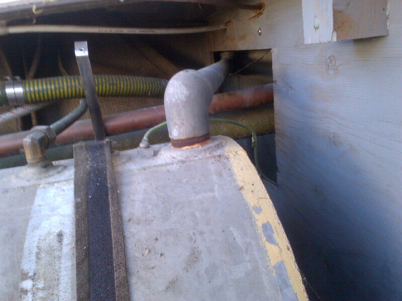

You can get to the hose behind the teak panel inside your salon's side cupboards. Why not cut the hose and replace with new they are old. Then you can remove the fittings at the top of the tank with a pipe wrench... once you remove the large hatch in the aft deck it will look obvious. Here is what mine looked like when we replaced aft stringer and deck core.

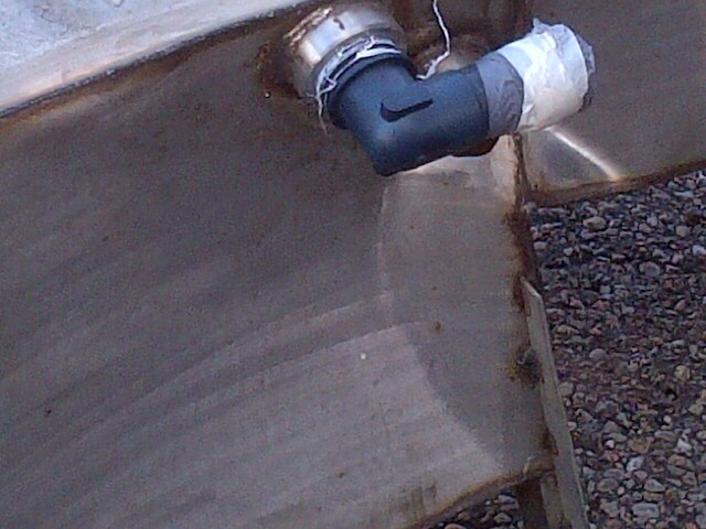

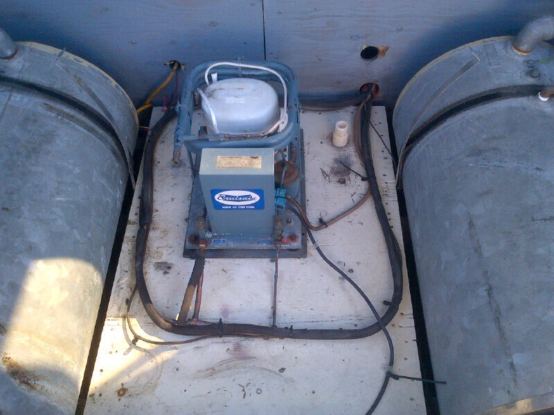

The before pics----looks familiar heh--- tanks look ok but are 36 years old,time for a change methinks
Re: Removing f32 aft gas tanks

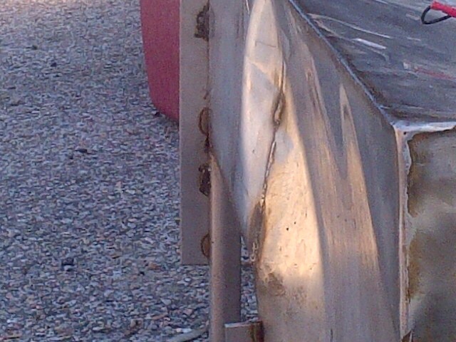

This is the holding tank that was sitting in the middle over the air---- look what happens with a little too many inches of vac.
