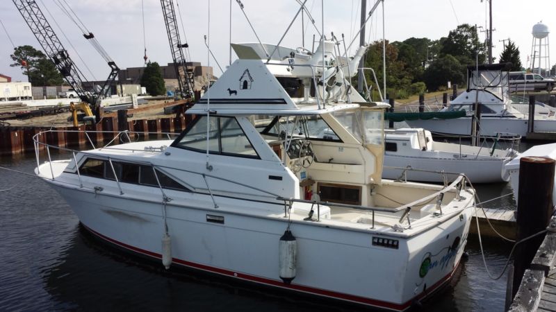

Sounds like there is no check valve at the tank . Most likely not the problem but also needs to be addressed for safety as does auto fuel pump . I believe you can increase the fuel capacity , measuring is the way to figure it out . You would be better off replacing the tanks due to age (assuming oem) with larger ones . See what the marina techs say about the issue
2 speed trans ? I know of none for you application . Not sure how far you have to go for tuna down your way , but the F31 is not really a off shore boat . You would rally have to pick your days carefully .
Is the Boat at Cobbs in little creek ? Looks like it from the photo

@ prowlerfish yes it's at cobbs lolz. Good eye. I hear that alot about the f31's not being true offshore boats. Why is this? They are huge and heavy!!! 31ft long 11'9" wide?
