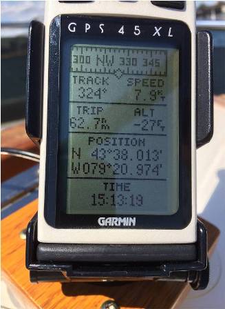

There are also the stupid silly bugger questions... are you reading 3000 on the tachs on the console, or a separate handheld tach connected directly to the engine (there is a switch on the tach for #cylinders, and if it is set to 6 instead of 8 it will scale incorrectly). How are you measuring the 20mph - speedo connected to a thru hull (that may be fouled or not spinning freely), or separate GPS?
Don't get me wrong - I am not trying to insult your intelligence, but sometimes people get messed up by blindly following instruments and don't realize that marine instrumentation may not be as accurate as what your car has, for various reasons....
GPS may even has its issues .. yes, mine is a bit 'old school', but if my altitude was really -27 feet last week (on Lake Ontario), I would have been in serious trouble!
- GPS Pic.jpg (26.77 KiB) Viewed 7515 times
