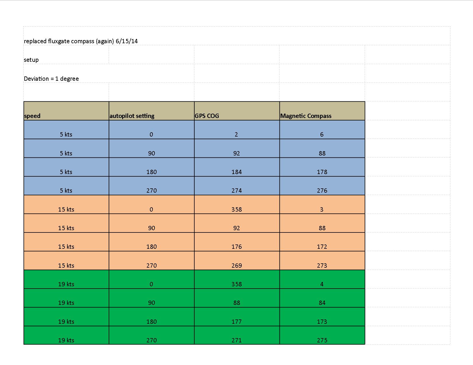

I just replaced the fluxgate compass (third one in 8 years) on my 2006 A.D. ST 6001 C Series Smart Pilot multifunction radar/autopilot/star wars gizmo.
I choose a better mounting location this time, resulting in a deviation of ONE DEGREE.
After the setup Iran N, S, E, & W at three different speeds, noting the autopilot setting vs. GPS COG vs. magnetic compass setting.
Base don the numbers below should I add (or subtract) a couple of degrees or just leave well enough alone?

Is your GPS and auto pilot interfaced? If not, don't mess with it. All three headings are coming from different sources. I use my auto pilot only to go in a straight line after I get her on the course I want. With set, drift, current, wind, ect... you will be hard pressed to get all three to read the same heading
