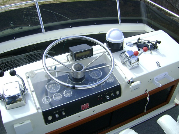

Here is a picture of the synchronizer. Not the best pic but all I have right now, will take a better one this weekend. Yesterday I removed the name on the back of the boat. Now it's time to choose a name.

Happy ours , I belive your unit is basicly a twin tach that you use to get both engines at the same rpm . the Gsynchronizing is in your hands .

As Paul says, most synchs are just there to tell you if you are off... Original synch on my F32 did this by lights (to show if one engine was running faster), current synch is an analog gauge and the needle points towards whatever engine is going faster (if its straight up I am in synch). Sounds like your 'synch' is more of a 'dual tach'.
