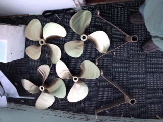

well just picked up my props from the shop and got a pair of 4 blades for a good price, thanks Simcoe prop repair. they look so nice I hate to put them in the water, lol. I have a stupid question as I didn't pay attention when I removed them. what is confusing me are the engines, I have a tri-cabin and the engines are mounted backwards, do I follow the rotation marked on the engines of do I reverse the props.
any advice would be greatly appreciated

Looking at your photo Port over Starboard on the rack as I see it.
Michael
Done Dreamin'
Re: Props
Right hand prop, RH marked on prop goes on starboard side. Providing current setup is original.
