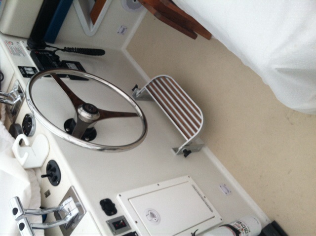

Installed folding helm step
Post by BobCT »
Thanks to Michael for posting this a few weeks ago. The only issue is I thought It would lock in a horizontal position (as shown in the website pics). You can't really do that because the locking knobs don't provide enough tension so the slightest pressure causes it to slip downward. There's a bevel cut into step bracket so it's designed to be in this slightly downward position. It's probably more comfortable like this anyway.
It does fold out of the way if needed. I believe I paid $160 delivered.

Looks good.... Time to go cruisin?

You've been busy, Bob. Looks like a good job.
I think it'll really make for a more comfortable position at the helm, especially if cruising for more than a couple of hours.
Thanks for posting a photo of the helm step. I have been thinking about a similar step for my Tricabin helm. I think that now I will go ahead with that project.
