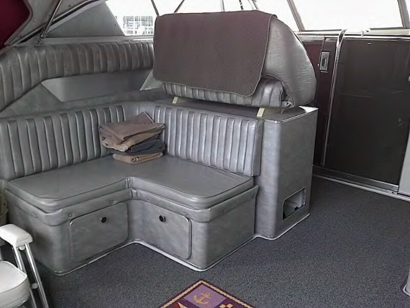

This is my port side seat.
Seat 2.jpg (143.52 KiB) Viewed 4052 times
John
