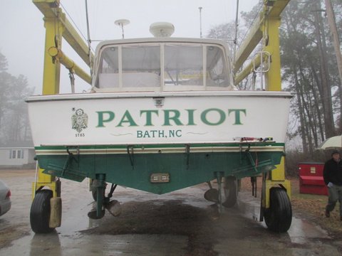

I got prowlerfish's message. Is there any way to see a photo of the transom and the tabs?
Tom
