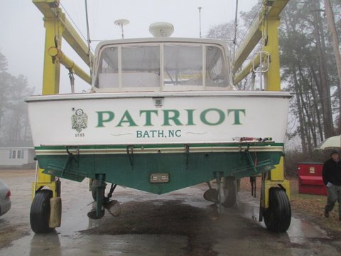

I just recently purchased a 1987 11 Meter International. The former owner had always had to use full trim tabs down in order to get the boat on plane. My surveyor and several other boat people have recommended for me install wedges on both left and right of the port and starboard trim tabs to help get the boat on a plane with out the use of full tabs. There is a lot of pressure on these tabs and I know they will not last. I would like to have use of my trim tabs if I ever got into a situation where I need them but the way it is now they are useless. Even with the full tabs, the boat really never planes out.
I was wondering if anyone has tried this and what there success was. I do not want to over wedge it because that would cause a Bow steering issue but there has to be a happy medium. The boat has twin Detroit Diesels at 450hp each.

I got prowlerfish's message. Is there any way to see a photo of the transom and the tabs?
