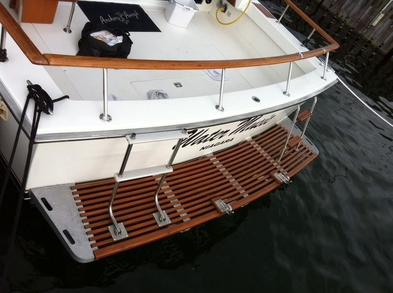

I redid mine a few years ago and went with Cetol (regular, not Lite). If your platform is the same design as mine, it can be a bugger to take apart (board by board), and get them all back in place again. Doing so makes it a lot easier to strip and sand each plank, and refinish them all before reassembly, but a LOT of screws and hidden screws to deal with. Whatever you decide to use, don't use anything slippery... varnish is a bad idea, as is Cetol Gloss.

Mark, I have a 76 F32, removed the original teak platform last fall. Brought it home and had it planed down on a 30" planner at a furniture factory. At 1/16" per side, 1 pass bottom 3 passes top, equals 1/4". Results are real good but still had some rough spots ( hey it's 37 years old ) proceeded to sand top and bottom working my way through 60, 120 and 180 grit. Now were smooth and clean, just waiting for warmer weather for my 5 coats of finish. I removed the platform with a simple pair of plyers. I did not remove the support brackets, mine our chrome and in good shape. Hope this helps.

I did my platform the same way and it was allot of work but well worth the results. The aluminum castings on mine were looking a little dull and didn't do the refinished wood any justice. To remedy that I had them powder coated white.
I'm happy with the way it turned out.
