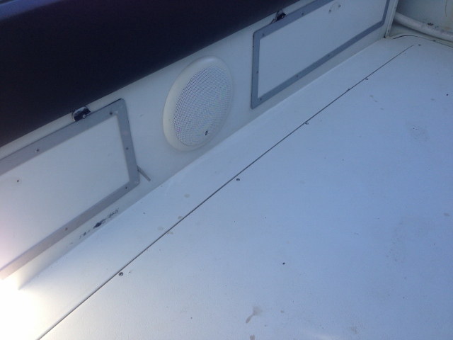

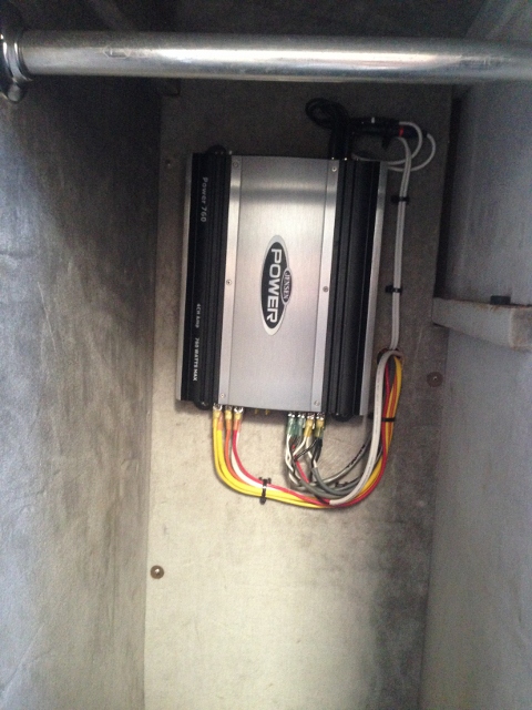

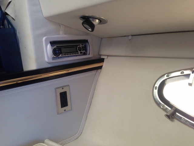

I have the stereo head unit installed in the corner behind the dinette. Amplifier is in the locker in that same corner. This was maybe a 15 ft run from the batteries in the engine room. I've got two speakers in the salon, two on the bridge, and a sub in the cockpit. I don't have the amp running off a separate or isolated battery but I have 4 group 31 batteries in the boat so I don't worry about draining them.
The amp in the closet does give me trouble with overheating when I push it hard. I am going to install a couple 12V fans and an aluminum finned heat sink. I don't have nearly as much power as Barry, so I doubt I will need a liquid cooled system.
