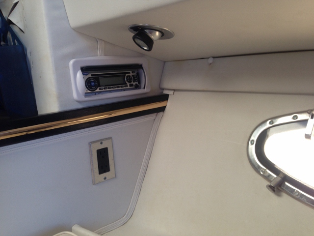

What model do you have? On my 10m mid cabin , I mounted it inside the locker next to the stairs. I installed a 10" subwoofer behind the "L" bench which is on the Stb side on my boat.

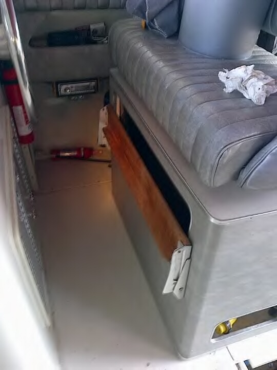

On my 1983 10m Express Cruiser it is located directly below the receiver, in the stbd side closet of the fwd cabin

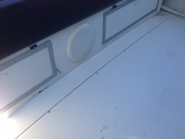

In the rear of that closet are two 1000 watt amps to run the 8 speakers in the cockpit. Two permanently mounted in the arch facing down and two more on the arch on articulating brackets that can be faced forward or aft depending on if we are swimming out back or cruising, (Polk White outdoor speakers) two more at ankle height as you approach the stairs and two more at base of arch facing inward and then of course some eye ball tweeters here and there to balance the frequency response in the cock pit.
On the forward side of that compartment is a 3000 watt amp to run the four 10 inch sub woofers in the cockpit that are mounted in the side storage compartments just aft of the Side steps.

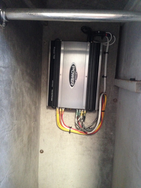

I have the stereo head unit installed in the corner behind the dinette. Amplifier is in the locker in that same corner. This was maybe a 15 ft run from the batteries in the engine room. I've got two speakers in the salon, two on the bridge, and a sub in the cockpit. I don't have the amp running off a separate or isolated battery but I have 4 group 31 batteries in the boat so I don't worry about draining them.
The amp in the closet does give me trouble with overheating when I push it hard. I am going to install a couple 12V fans and an aluminum finned heat sink. I don't have nearly as much power as Barry, so I doubt I will need a liquid cooled system.
