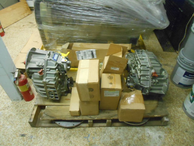

The CL ad is indeed inaccurate, as the seller is very uninformed. The engines were purchased by the seller's brother in 2005, and the brother has since passed away. Ad says Velvetdrives, when the trannys are ZF Hurth. The ad also indicates the engines are v12's, so you get an idea of how much he knows about them.
Anyway, you guys have been very helpful, and have confirmed these packages are not the best choice for an F32. At the very least, I would have to buy different tranny's, as these are 1.99:1 with up-angle output (What's with that anyway? V-Drive application maybe?). As mentioned by someone, with the small prop constraint on an F32, a shaft RPM of around 2400 is necessary for a 20+ kt cruise.

up angle ? most ZF are straight or 8-10 deg down a A after the number means down angle .
- DAVIDLOFLAND
- Posts: 352
- Location: Anchorage, Alaska
Re: John Deere 6068tfm75's in an F32
Angle looked weird to me too. In the image, you can just make out the angle on the tranny on the left. I looked at them in person, and the output flange definitely angles up.
