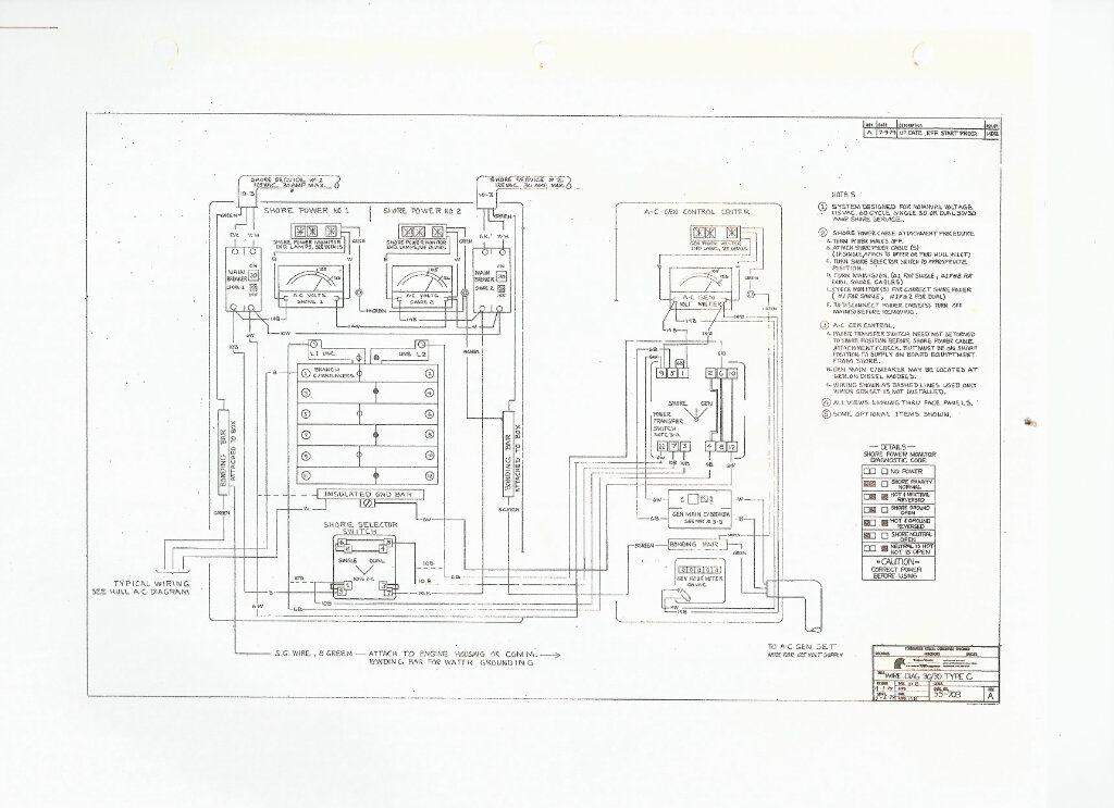

Re: Shorepower indicator lights - Int'l
This is the AC schematic for my 10 meter. It shows the shore power monitor diagnostic code.
- AC Schmatic.JPG (117.73 KiB) Viewed 9864 times
John,
Thanks, that's also imprinted on the panel itself. So after screwing around with the LED's, I ordered the ones that Harris posted. They're only two bulb displays though so the legend on the panel becomes useless.
Now I'm thinking of just remaking the whole panel so the indicator lights will have the right size hole and it'll look brand new. Mine's not in great shape anyway.
I'll let you guys know what I do.
