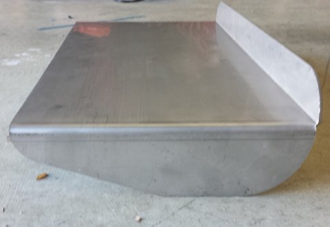

Obaby I am working on my 84 11 meter express tabs now. I would agree that they are way too small for our big boats, but have been told the Delta Conic hulls don't need more. I disagree. I have to run tabs full down to get the best results on my flo-scan, and I am running 4 blade 23" X 24"props behind frest 454's. My factory tabs are Boat Leveler brand, 8" X 24" single cylinder. I don't think longer tabs will work given the placement of the rudders. I am installing some 12" X 24" with 3" drop fins to the existing factory tabs. I made them from 11 ga 304 stainless. I too am interested in Tabman's recommendations. Please let us know which way you go and the results and I will do the same.

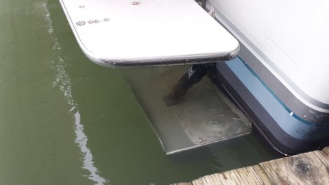

Tabman- I have 8x24" tabs but I'm not sure of the MFR. How do you tell ? I know they're original..
Unfortunately I'm still in the water..(San Diego is 80 degrees at the moment, sorry to rub it it ) Will a in-water photo be enough ? or is there a way to tell....?

Patrick,
One way to tell is to look at the HPU (pump).
Also the Boat Levelers have exposed rubber hoses outside the transom and the Bennetts usually have no tubing visible outside the transom.
Tom

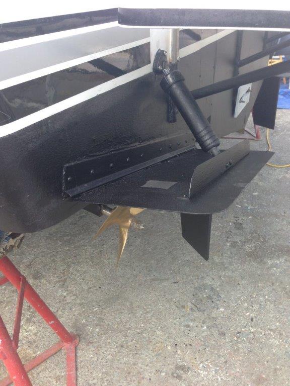

Well I went with the Bennett 12 x 30" tabs as suggested and they fit perfectly. Finally this boat will have the proper sized trim tabs.
Thanks for all the help guys... Cant wait to test the performance...

Looks good. I am very interested in the results. I went with 12 x 24 with drop fins. I was concerned about rudder clearance with the 3" drop fins.I too am awaiting testing and will post results as well.
