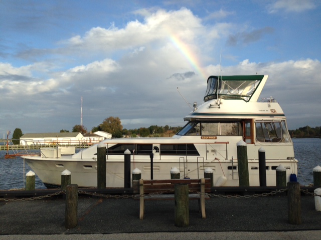

Trojan s.JPG (112.43 KiB) Viewed 8952 times
Attached is a picture of the boat.

Nice Boat .
I don't belive you will see the speeds Doug listed The 2 F40s I know with the same engines don't run that fast . But with that said I do belive you should be much faster the you are .

drew, thanks for the portside pic. she is beautiful. so she was the family boat and passed onto you? where do you keep her?
