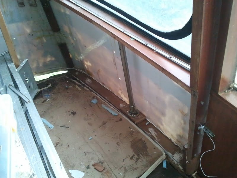

I'm rebuilding the cabin walls on the upper cabin, 42 Ft 1969, previously, there was some Styrofoam SM poorly installed between a sheet plastic, similar to Lexan outside skin and 5/16 mahogany ply inside. I would like to know if I should allow any airflow or airspace when I re-install the SM. I'll use a straw foam to set in the SM. I would also like to add some acoustic fiberglass panel in the extra space, is there a chance of moisture buildup?

I've attached a picture of the rebuilt top of the transom and wall taken inside the cabin. The 'Lexan' is material used for the outer skin. Thanks.

is that the aft deck? i believe the 'lexan' that you are talking about is the 'weather skirting' (it dresses the area around the railings) that is used to semi enclose the aft deck of flush deck motor yachts.
Re: Cabin wall insulation
That photo clears up a lot That foam is not factory for sure, I don't think the plastic is ether . Not sure what Trojan used (canvas ? ) But I believe there was a gap at the bottom when it was built .
I would leave the foam out , unless you have a reason for it .

I'd like to get some insulation in there since we may live aboard next (Canadian) winter, plus the fiberglass will add some sound baffling. Thanks.
I see, I still want to insulate it, if you have any tips. Cheers.aaronbocknek wrote:is that the aft deck? i believe the 'lexan' that you are talking about is the 'weather skirting' (it dresses the area around the railings) that is used to semi enclose the aft deck of flush deck motor yachts.
The boat is a Shepherd, the Canadian subsidiary of Trojan, from what I have seen.prowlersfish wrote:That photo clears up a lot That foam is not factory for sure, I don't think the plastic is ether . Not sure what Trojan used (canvas ? ) But I believe there was a gap at the bottom when it was built .
It looks like this area was originally open air.
http://www.shepherdboats.com/Boat_Model ... Colour.pdf page 6

Arron is right, there used to be weather skirting or weather boards around your aft deck. Paul is right as well about the gap at the bottom. The gap is actually a important design feature. It would let water drain off the aft deck in a seaway and also allow the wood to breath and dry out. Without this gap you need to make it completely waterproof or the wood will start to rot on the inside from standing rain water. Just from what I see if you insulate the lower part I don't think you are going to see much in the way of heat retention if you still have the canvas enclosure above it.RobertS wrote:I see, I still want to insulate it, if you have any tips. Cheers.aaronbocknek wrote:is that the aft deck? i believe the 'lexan' that you are talking about is the 'weather skirting' (it dresses the area around the railings) that is used to semi enclose the aft deck of flush deck motor yachts.

+1summer storm wrote:.....I don't think you are going to see much in the way of heat retention if you still have the canvas enclosure above it....
