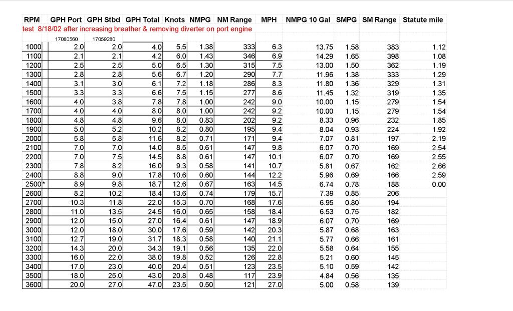

What do you estimate your fuel burn per engine assuming your hull speed to be the same as mine at 6.5 knots?
Whatever it is your savings will certainly be less than 50%
I cut and pasted my detail data from 2002 with the 454 gas engines running quadrajets.
This shows a fuel burn of between 2 - 3 gph per engine at hull speed.
The 10 meter has a wide beam with the engines placed wider apart than on a typical 33' boat.
This forces a hard rudder angle with one dead engine.
Add to that the additional drag of the dead running gear.
Add to that the higher RPM of one prop required to run at a given speed vs. 2 props.
Lets figure high.
Assuming 3 gallons per engine per hour - six gallons per hour total fuel burn, and an efficiency loss of 20% (pick your own number, but I'd bet its closer to 40%)
six gallons at $4.00 gallon is $24 per hour.
Assuming the above, I'm burning 3 gallons per engine, or $12 per hour per engine.
So I can save $12 per hour less the efficiency loss of 25 % which equates to $3 resulting in a savings of $9.00 per hour at hull speed.
If you had flowscans - you could run a TRUE test to see how much more fuel one engine would burn vs. two at hull speed.
For me, I'd run hull speed for the savings, but would run both engines.
Here's the cut and pasted raw data from my vessel.
DETAIL ON THE CHART:
after change to 18x19 pitch by Coastal Prop Technology, Inc.
Carbs previously swapped port & stbd
carrying 202 gallons gasoline in a 242 gallon tank
carrying 17 gallons diesel 17 gallon tank
full water tank - 40 gallons
2 adults & 1 yellow lab
Lets figure high.

RWS, I didn't see your attachment on your post.
I don't have an exact LWL for the boat, but assumed it to be in the 35 to 36 range, since my LOA is about 39. Based on that, I calculated a max hull speed to be between 8 and 9 mph. At approximately 1500 to 1600 RPM's with both motors, I cruise at about 7.8 to 8.2 mph. I do not have a flow meter, so I do not know what my current burn rate is at that RPM. With one motor, at again 1500, I slow to about 6 mph. Both my carbs need to be rebuilt, so I will probably put the flow meters on then.

At this rate, a 40 mile trip will take 5 hours, and you would burn 35 to 45 gallons of fuel. At $4.95/gallon, you're looking at $173 to $223.
At 3100 to 3300 RPMs, I'm running about 20 MPH, and probably burning 32 to 38 gph (I'm taking this off a previous post of someone running a flow meter on a 10 Meter Mid-Cabin, which is probably lighter than my boat). I'm down to 2 hours of travel. Now you're burning 64 to 76 gallons of fuel over that 2 hours. At $4.95 gallon, I'm looking at spending $316 to $376. That's about $143 to $153 MORE in fuel.
If this is all accurate (which I need to buy a flow meter) that is certainly some significant savings.
Now lets see, a diesel boat would burn about 2 to 3 gallons per hour and only costs $4.25/gallon. Although at about $100,000, that may take awhile to make back in fuel savings.
If I do run one motor, I can adjust my packings to drip more, and I am not concerned about the Velvet drive Free-wheeling. Its the Walter V-drive that I am more concerned about. If I could run 8 mph (1550 RPMs) and burn 7 to 9 gph I'd be happy. Gas prices in this area are about $4.95/gallon.
